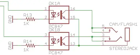

Here's an example of the circuit used within the Camera Axe camera / flash triggering system that may be indicative of what you'd find within the camera:
Camera Axe output driver

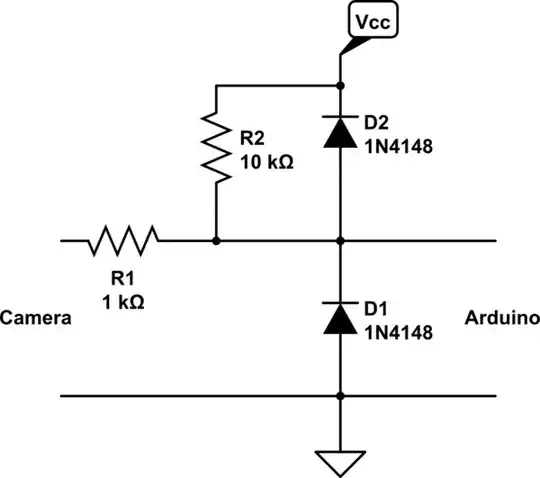

I didn't have a D5100 available for testing but measuring a family member's Nikon D7000 and my Canon 5D Mark III no voltage was present on the hot shoe. In both cases measuring the flash while detached from the camera but powered up gave a reading of around 5V so it appeared both systems used a pull-up within the flash. I'd suggest a circuit such as the following that I just tried with both:
schematic

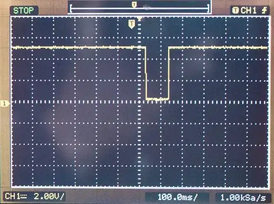

R2 could be omitted if you use the internal pull-up on the input line while the diodes just give a little extra protection against ESD and over-voltage situations rather than relying solely on the clamps within the AVR. Here's an example of the measured signal for a 1/10 second exposure using that circuit:
Flash hotshoe measured signal

  • Okay, I'll go with the external solution. So if I understand the circuit properly, when the flash is triggered the current will flow through R1 then D2 and R2 which will produce the voltage drop. – Duom Jul 15 '13 at 11:13
  • R2 doesn't drop the voltage, it's called a pull-up (you'll find questions here about how it works) and it means when the input is open the I/O line is a known state, but can still be pulled low by the camera. R1 limits the current a bit so that D1/D2 can cope with over-voltage, like static or if the camera does output a voltage above/below the AVR voltage (it's called a clamp). I think the confusion is imagining the hot shoe as a voltage output. I expect what you're measuring is a small leakage current, think of it like a simple switch and it should be clearer. – PeterJ Jul 15 '13 at 11:28
  • I read some explanations about pull-up, I think I understand it better now. Still if I see the camera as a switch, I should then read high on the arduino and low when the camera is triggered, no ? I did the schematic in a simulator and that's what I read: http://goo.gl/ljHdN – Duom Jul 15 '13 at 17:33
  • @Duom, yes that's right, the input will normally be high and go low when triggered. – PeterJ Jul 16 '13 at 01:12
