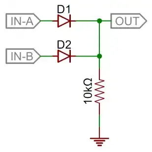

In this circuit enter image description here
Why is there a resistor if the ground already is 0V?

This circuit is supposed to act like an OR gate. You need the resistor for the diodes to work correctly, especially in the off state.
$$\begin{array}{|c|c|c|c|} \hline \rm A & \rm B & \rm D1 & \rm D2 & \rm Out \\ \hline 0 & 0 & \rm off & \rm off & 0 \\ \hline 0 & 1 & \rm off & \rm on & 1 \\ \hline 1 & 0 & \rm on & \rm off & 1 \\ \hline 1 & 1 & \rm on & \rm on & 1 \\ \hline \end{array} $$
When A and B are both zero, D1 and D2 are both off. Without the resistor, the output node would float, meaning it would be affected by nearby electric fields and static electricity. In general, you should always have a DC path to ground for every node in your circuit.

The resistor is not intended to change the ground (which is our 0 V reference).
It is intended to ensure that OUT is pulled to ground when both the input signals are low.
Another way of saying it is that R is to ensure that any stray charge on OUT is discharged to ground and that OUT falls to 0 V rather than float at an undefined level when IN-A and IN-B are low (0 V). Don't forget that the charge can't dissipate back through D1 or D2.

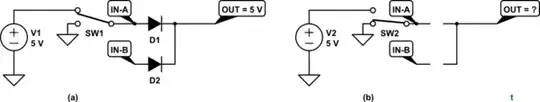

Update for clarification:
schematic
Figure 1. (a) With one diode forward biased the output is a definite +5 V (less the voltage drop across the diode). (b) With neither diode forward biased the output voltage is undefined. They are effectively out of circuit. Vout can float to any voltage between 0 and the reverse breakdown voltage of the diodes.
schematic
simulate this circuit
Figure 2. If the following stage presents a path to ground then the problem is solved.

The reason the resistor is in place, is to ensure the output stays at 0V when the output is logic '0'. This is also known as a pull down resistor.
The circuit is essentially an OR gate (as pointed out in the answer by Adam Haun). When one of the inputs becomes a logic '1', the output becomes logic '1'. If both inputs are at logic '0', the output is '0'.
Now, if you imagine the output is connected to something. Without a pull down resistor, the output is 'floating'. If some excess noise or static or some other type of electrical interference occurs, then it could cause the logic level of that output to become undefined, so it is 'floating' between a logic '1' and '0', and could have undesired results. In an ideal circuit, the resistor would not be needed, but, alas, in the real world, things are not ideal. The resistor ensures any stray interference has a path to GND, which keeps the output at 0V, or a logic '0'.

Another thing to mention, is don't assume that ground will always be 0V. If that circuit was hooked directly to a battery and there was no other circuitry, then it most likely would be 0V. However, once you are adding other circuits that share a common ground and factor in noise (from a spinning tire on a car or factory equipment for example) that voltage may rise slightly and it could be enough to make your circuit read a logic 1 voltage.

The simple way to explain it is this. If OUT is directly connected to GND, then IN-A and IN-B don't matter. OUT will always be low. So, OUT cannot be directly connected to GND. With the resistor, OUT will be low whenever IN-A and IN-B are both low. But it is possible for OUT to be high when IN-A or IN-B is high.
If the resistor is removed, then OUT may tend to stay high even when IN-A and IN-B are both low. The diodes prevent IN-A and IN-B from pulling OUT low.
