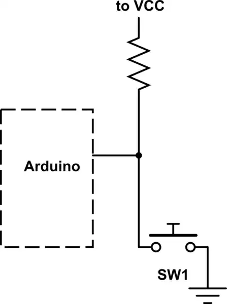

You do not need a resistor, as long as you set up the pin to be input. The current protection resistors are necessary only in cases where the Arduino pin is used as a current source, i.e. output. If the pin is used as an output pin, you may need a current-limiting resistor, depending on what is connected to the pin. Usually we don't connect switches to outputs though (except for unusual cases when the switches need power, switches are actually circuits, etc).
For an input pin you may want a pull-up or a pull-down resistor. However, all AVR chips have built-in pull-ups. After you configured the pin as an input pin, you activate the pull-up resistor by digitalWrite(HIGH) to that pin, or, as @mpflaga points out, on the newer Arduino toolchain, you can set the input mode and pullup using pinMode(in_pin, INPUT_PULLUP); line. See here for more information on pull-up/pull-down resistors.
If you want a discrete pull-up resistor (i.e. not use the built-in one, though I don't know why you would do that) the circuit would look as follows:
schematic
The pin will read high when the switch isn't pressed, and low when it is.

    Note latest Arduino IDE has a pinmode command to make it more clear. pinMode(in_pin, INPUT_PULLUP); http://arduino.cc/en/Reference/PinMode – mpflaga Mar 12 '13 at 19:48
    Ah, cool. That's much clearer than the digitalWrite(..) version of that same. Thanks! – angelatlarge Mar 12 '13 at 19:54
