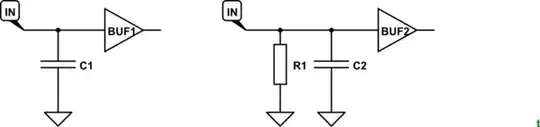

It's very simple.
schematic
Figure 1. A CMOS input and one with a pull-down resistor.
  • The typical input is very high impedance - so high that we can usually assume that no current flows into it in the steady state. The input has some very small capacitance, however, and this needs to be taken into account at high frequencies.
  • The input impedance is so high that the input can be affected by stray or induced voltages.
  • Adding the pull-down resistor discharges any voltage on the input capacitor and the input is held low.

  • For beginners, you will want to make it explicit that no current through a resistor means ZERO voltage drop across the resistor which is the same as shorting it to ground with a piece of wire...
    Except for the difference that if you do apply a voltage to the input it can override the pull-down resistor *unlike if you just shorted the input to ground with a piece of wire rather than a resistor).
    – DKNguyen Aug 23 '19 at 08:00
    Just adding for clarification: The noise, simplified, is a product of the current x impedance. So a very small current flows, but a very high impedance still equals a large induced noise. When adding a resistor in parallel, not only do you give the parasitic capacitive effects a better discharge (R*C) but you also reduce the total impedance by the reciprocal value of (R1^-1+InputImp^-1)^-1, thereby reducing the induced noise. – Sorenp Aug 23 '19 at 08:05
  • Let's see if I understood this correctly: V = IR. So because the resistance of the input pin is very high, just a tiny amount of current is enough to flip it over the threshold and count as a 1. (Not really sure what the difference between "stray voltages" or "induced voltages" is. Stray electrical current vs current induced by a magnetic field?)
    How does the pull-down resistor discharge any voltage on the input capacitor? What happens to the current if it doesn't go back out into the air or into the input pin? Is it stored in the electrical circuit or the resistor itself?
    – Magnar Kleppe Aug 23 '19 at 10:01
  • See those little triangles pointing down? These mark "GND" ("ground") as the (sic!) ground potential and connect all terminals on which they are set. So the charge on the capacitor (or the voltage coming "over the air" which means the same for our view here) will create a current through the resistor. Currents always flow "in circles", so this one gets back to the capacitor. Your question is likely more "Where does the energy go?" Well, it is lost as heat through the resistor; this is where all energy will go in the end. – the busybee Aug 23 '19 at 10:54
  • This answer and the discussion here has cleared things up for me, so for that reason I will accept this answer. Thanks everyone! – Magnar Kleppe Aug 26 '19 at 06:48
  • The capacitor causes charges to build up, while the resistor discharges it to ground, keeping the voltage from build up and switching MOSFET – Mitu Raj Aug 26 '19 at 10:57
