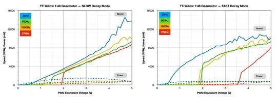

Here is some test data showing the quite complex interaction between PWM frequency and speed response of a cheap 130 size brushed DC gear-motor:-

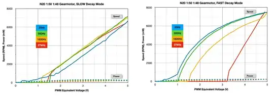

And here are the results for a typical N20 size gear-motor:-
In both cases the throttle response with 'fast decay' (diode freewheeling) is terrible. At 27 kHz the motor doesn't start until the PWM ratio reaches 65-70%.
