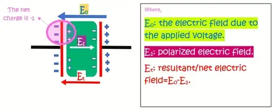

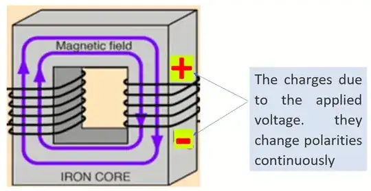

The transformer core once voltage is applied one side will have +ve charges and -ve charges on the other side as shown on the first figure. This separation of charges by the applied voltage will cause the core to become polarized (positive charges will be separated from negative charges inside the core). So, as the second figure shows the core positive charges will be attracted to the applied voltage negative charges (opposite charges attract each other) and the core negative charges will be displaced towards the applied voltage positive charges. Thus the core will produce its own field E1 which opposes the applied electric field E0. E1 is what produces the back EMF. So, the resultant field, E will be less than E0, But, in the same direction. The opposing electric field slows down the change of current.
Back EMF changes instantly but the induced current in the core can't change instantly since the current is di/dt (dt≠0).
the back EMF is proportional to the amount of change of the current, the larger the current changes the larger the EMF is.
EMFs can be generated in a wire in three different ways: by moving the wire (motional EMF), by moving a magnet near the wire, or by changing a current in a nearby wire.
As it has a voltage opposite to the applied one, so, it goes back into the source to oppose the current thus the name back EMF.
Am I correct?

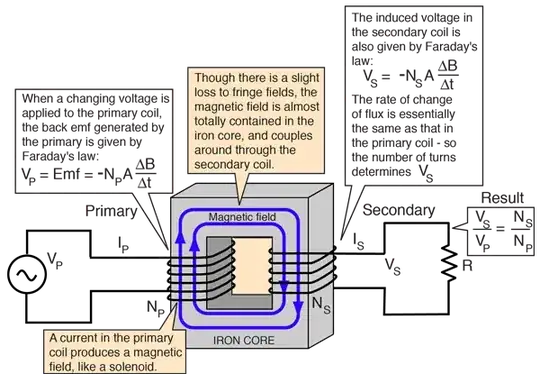

  • There are a number of items confused in your post. You are showing an open-circuit on the secondary so there will be no current flow in it and it won't affect the flux. I can't see the relevance of the capacitor diagram. – Transistor Apr 27 '21 at 14:12
  • I think you are taking the blue arrows in the core drawing to buy electric current. It's not. It's magnetic flux. Current in the coils induces flux; changing flux induces voltage (EMF). In the driven coil, this voltage resists the change in current. Hence, back EMF. – TimWescott Apr 27 '21 at 14:18

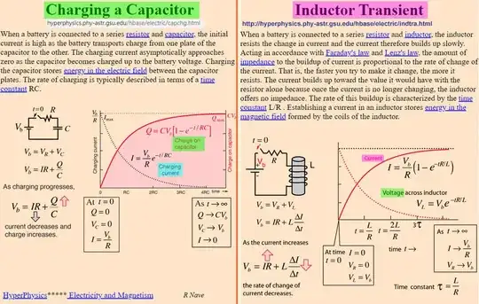

For an inductor, say, if you apply a voltage across it, current increases exponentially and after some time, to an almost steady current (Appendix A).
For this almost steady current flowing, there is a magnet field built up, which stores energy, and let us call it magnetic energy.

Appendix A - Inductor current, magnetic field, and magnetic energy
Inductor current
Appendix B - Magnetic Energy
Magnetic energy

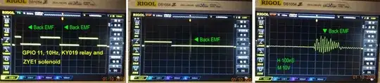

Appendix D - Displaying the waveform of a back EMF voltage wavelet
Two years ago I used an electromagnetic buzzer to switch on/off the current in the buzzer inductor coil, attracting/releasing the spring flap current making/breaking contact. There is no flyback diode. I also tried using relays and solenoids without flyback diode. I used a scope to display the current pulse, as shown below.
Ref: A Portrait of the Back EMF as a Wavelet - Rpi.org.forum 2019jan10

This question contains a new mixture of misconceptions.
You should remember that induction happens in space where magnetic field changes for any reason. In transformers the magnetic field occurs mostly in the iron core as you have drawn. That's the peculiar quantum physics effect (ferro- and ferrimagnetisms) how external magnetic field caused by current in wires succeeds to persuade the molecular magnets to take the same magnetic field direction as the external field. Thermal random motion tries to disturb it, but in normal core materials the magnetic flux is easily hundreds of times stronger than the same windings and current would cause in free air.
Essentially Faraday noticed that changing magnetic flux in the core generates immediately (=at the same time as the change occurs) a new field which is in the same space as the magnetic field and around it, but directed differently. It's the induced electric field. It does not diverge outwards from charges, it exists as closed loops around the growing or weakening magnetic flux lines.
In transformers the induced electric field is circularly around the core just like the turns of the windings. It pulls electrons along the wire so that a substantial voltage can occur between the ends of a winding. +pole is that end where electrons are pulled from and -pole is where the electrons accumulate to.
The circular field electric field is also inside the core. That's why the core of the transformer should not be conductive. It can be made of ferrite which is an insulator. Iron sheet cores are divided by thin insulation layers to separated small areas so that no circular (=eddy) current can exist around the core. Eddy current would affect like a shorted one turn winding.
Faraday noticed that the induced voltage between the ends of a winding is proportional to the changing speed of the magnetic flux. At the same time (with no idea what Faraday tinkers) Joseph Henry invented that induction happens also in a single coil if the current in the coil changes. That's a special case, where the cause of the change of the magnetic flux is a growing or decreasing current.
The back EMF is a thinking model of that phenomena. Many of us who work with circuits think that there's an internal controlled voltage source in an inductor. The source voltage follows equation V=L(di/dt) where the proportionality factor L is called inductance and di/dt is the changing rate of the current. Many of us insert minus sign in front of the L(di/dt) because they have bolted themselves to think there should be some indication for the fact that the internal voltage source has the polarity which resists changes of current.
I do not need that internal voltage source to stay calm. It's enough that the voltage between the ends of an ideal inductor is L(di/dt). Resistance or other non-idealities can be modeled by inserting additional parts and another inductor which is so near that its magnetic flux substantially intersects the first inductor can be taken into the account with mutual inductance.
Your capacitor analogy is nonsense. In capacitor the electric field is between the charged plates. The field starts from +plate and ends to the -plate.
The induced electric field which can be seen as voltage between the ends of a winding is circular around the core like the wire turns are - the field has no start nor end points. But to stay in truth I must add, that there happens in capacitors something which is analog with the induced electric field in inductors. See in the end part "Maxwell's own invention"

It takes a small number of ampere-turns to magnetise the core. In a properly designed transformer the primary winding will be designed so that it brings the core close to saturation to get the most benefit from the weight. The changing winding voltage induces the changing core flux which generates the opposing EMF and this limits the primary current to a low value.
Now consider that secondary current will "eat" the flux in the core and reduce the primary back-EMF. As a result the primary current will increase to restore the balance.
In effect, primary ampere-turns = secondary ampere-turns + a small constant, where the small constant is due to leakage.

So, as the second figure shows the core positive charges will be attracted ... No, that image is irrelevant as it is about capacitors, not inductors.
Thus the core will produce its own field E1 which opposes the applied electric field E0. E1 is what produces the back EMF. No, there is only one flux (not a field) in the core. It's the same one that's induced and that causes the back EMF.
Back EMF changes instantly but the induced current in the core can't change instantly ... There is no current in the core. There is magnetic flux.
