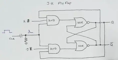

Is it possible that the schematic shown here is wrong? JK Flip Flop Wrong?

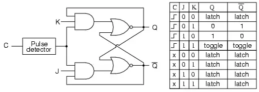

I would expect something more like that... enter image description here
It seems like that he inverted the feedback wires, but I'm quite suspicious because he made the circuit and it works, I'm a bit confused.

  • You're right. The feedback connections in his circuit are wrong. It stays stuck in the initial state no matter how J, K, CLK change. But it will work fine if he replaced all the gates with NAND. – across Apr 06 '20 at 10:05
  • @beccaboo so it means he made a different circuit on the breadboard, right? – Paa Apr 06 '20 at 10:14
  • If you'd had bothered to read through the comments below the post you'd see that several people questioned his misapplied cross-connection. Dodgy video. – Andy aka Apr 06 '20 at 10:16
  • @Paa say initially Q=0, then the bottom AND gate output in his circuit will be stuck at 0 forever. This makes the bottom NOR gate output to stuck at 1 forever. This makes the top NOR gate output to stuck at 0 forever. – across Apr 06 '20 at 10:23

Let's start with the The Ben Eater drawing. It's wrong - the feedbacks are crossed.

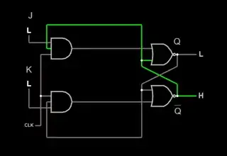

Ben Eater's broken version in Falstad
As you can see, this doesn't do anything.

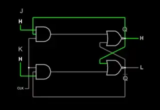

So let's fix the feedback connections...
try it here with Falstad. It oscillates
... uh oh, there's a problem. We now have a working (sorta) gated JK latch, and we can see this behavior:
  • J, K = 0, 0: hold
  • J, K = 1, 0: Q = 1, Qbar = 0 at clock rise
  • J, K = 0, 1: Q = 0, Qbar = 1 at clock rise
  • J, K = 1, 1: very bad things when clock is high
The expected Q/Qbar toggle with J and K high doesn't happen. It oscillates!
Why? When both the J and K inputs are ‘1’ and clock is high, the two NORs and ANDs form a pair of inverters wired head-to-tail. With all the inputs high, you have a ring oscillator, a useful circuit by itself (it's used in PLLs for example), but not here. This oscillation is sometimes called "race-around", and was a (mis-)feature of early JK flop logic designs (yes, including Jack Kilby's).

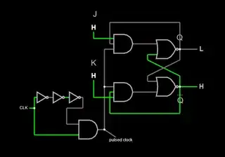

Nevertheless, in the interest of completeness, here's an example using a rising-edge pulse detector on the clock:
Falstad sim of JK latch with rising-edge pulse detect

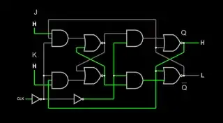

The second, two-stage approach is what's used in real chips, even early TTL devices like the 74xx73.
Here's a complete JK flip-flop using two latch stages. This is commonly known as a "master-slave" (not really PC anymore) or "edge-triggered" JK flip-flop:
JK flip-flop using a pair of latches
As expected, the flop toggles on clock rise when both J and K are high.

    And I added a proper JK flip-flop that uses a pair of latches. – hacktastical Apr 06 '20 at 18:47
