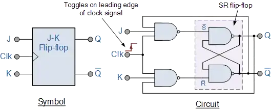

My background is in Computer Science, and this is my first time posting in electronics SE. This is a circuit diagram of JK flip flop.
Circuit diagram of flip flop
I don't understand how it works at the beginning, when the circuit is first on. In my understanding, Q and Q' does not have a value yet, then how does the circuit proceed? I was reading from this website. I have tried three more websites, yet did not find the explanation.

    Usually there is a reset/preset/clear signal to flops which you assert to set the flip-flop output to 0 or 1 initially + you don't tie JK inputs as floating. It should be either 0 or 1 always and start analysing from that point. – Mitu Raj Dec 01 '20 at 05:30
    It actually makes a lot of sense but what does "you don't tie JK inputs as floating" mean? – alu Dec 01 '20 at 06:34
    Floating means like "not connected to anything". You either feeds 0 or 1 to the inputs always. – Mitu Raj Dec 01 '20 at 07:11
    See https://electronics.stackexchange.com/questions/25629/how-does-a-latch-determine-its-initial-state and https://electronics.stackexchange.com/questions/14653/what-is-the-beginning-state-for-q-in-a-sr-latch and https://electronics.stackexchange.com/questions/24237/initial-or-undefined-value-of-flip-flop and https://electronics.stackexchange.com/questions/227482/sr-flip-flop-with-2-npn-transistors-initial-state – Sneftel Dec 01 '20 at 09:26
    @MituRaj The inputs don't need to be floating to make the initial state undefined. Consider the case with all inputs tied to 0. – Sneftel Dec 01 '20 at 09:28
    I said AND. Not OR. – Mitu Raj Dec 01 '20 at 10:08
    The logic diagram is bad. This is a JK latch, not a real clocked flip-flop. It has a hazard when J and K are both ‘1’ and the clock is high. See my answer. – hacktastical Dec 01 '20 at 16:39

The JK flop can power up in either state. With perfectly matched gates, the odds would be 50-50 for each state. It is up to the rest of the system to initialize to a known, desired state, or to not care about it. Same goes for a D flop.
It’s the same as having an uninitialized variable in a program. Until the variable is set, any values that depend on it (including itself) are not known.
Hardware simulation of this flop would show up as an ‘X’ state until it has had a 0 or 1 clocked into it. Otherwise, it will stay ‘X’ if both J and K are 0 (hold) or 1 (toggle).
In actual hardware (like software), unknown things could happen depending on how the unknown-state output is used.
A variant of this flop has direct set and clear inputs to force an initial state with separate signals (e.g., reset.) In that case a startup behavior can be defined.
MORE: the logic diagram shown for the JK is crap. This is actually a gated JK latch, and it has a hazard when both J and K inputs are ‘1’ and the clock is high: it becomes a ring oscillator due to the 'race around' issue.
Unfortunately, while the the linked article discusses this, it gives a mealy-mouthed answer about using a very narrow clock pulse to avoid the ‘race around’ issue. This is hugely misleading. Integrated circuit-based JK flops use a pair of latches wired as 2 stages ("master-slave" or "edge-triggered") and don't have the race-around problem.
Another complaint. The logic diagram given for the 74xx73 type JK is not only incomplete (doesn't show set/reset), it's wrong (74xx73 uses the 2-latch "master-slave" design, not gated latch.) I left a note for the page author for them to fix it.
This answer discusses the JK gated-latch problem in detail. SR FlipFlop Question
And here: JK latch, possible Ben Eater error?

  • This has a lot of information but my confusion is: Say at the beginning J=0 and K=1. So the J NAND gate would output 1, since any of the inputs zero implies the result would be 1. Now this 1 goes to the S' NAND gate, but since it is 1, we don't know what the result would be. Then if we go back to the K NAND gate, we can't know what the output would be, since if one input is 1, the output relies on the rest of the inputs. So how would the operation proceed from there? – alu Dec 01 '20 at 06:30
    You're right. You don't know what the output would be. It's in a random state (could be 1, could be 0) until the flip-flop is reset or a known logic value is clocked in. If there are devices further down the line from the flip flop which depend on it's value, they too will be in a random state. I think what you're missing, when you say "At the beginning J=0 and K=1" then talk about how S' and R' feed back. But you don't mention the state of the clock. That's a 3rd input to the Nand gate Consider your setup when the clock =0, then what happens when the clock changes to "1"?? – Kyle B Dec 01 '20 at 08:36
  • @alu, your concerns are valid. We can fix this by using an asynchronous input which sets the output to a known state. – Shashank V M Dec 01 '20 at 10:40
    The diagram shown is a JK latch with a hazard. Added this to the answer. – hacktastical Dec 01 '20 at 16:41
  • I read the answers multiple times, including the linked ones. I understand a little bit now but it's not clear. Mainly when I imagine physical circuit and it depending on the rest of the system, I imagine it works in a manner that I won't understand. And I understand initially when the circuit powers up, all of the gates including Q and Q' get some voltage somehow, possibly like John Doty said, and then they reach some state which makes the circuit working as desired. That's all I understand for now, and I am tired from trying to understand without any progress. – alu Dec 04 '20 at 06:52
  • As I said, if the gates are equal the state that the flop powers up is an even chance, influenced by noise. If they are not exactly the same there will be a bias toward one state over another. But that’s something you won’t see in an RTL sim in Verilog or VHDL. You’d have to model it in Spice using low-level components. – hacktastical Dec 04 '20 at 08:59

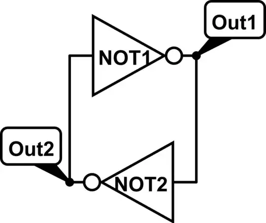

When power first comes on, this can't be understood as a digital circuit. To the actual physical circuit, inputs and outputs can be between 1 and 0, or even beyond. Part of designing logic primitives is hiding this from higher level design, but it's a "leaky abstraction". Consider the following simple example:
schematic
Now, plainly, as a digital circuit, if Out1 is 0, Out2 is 1, or vice-versa, forever. So, what happens on power-up?
Imagine that on power-up, both Out1 and Out2 are 0. In that state, Not1 and Not2 will slew their outputs toward 1. But somewhere in between 0 and 1, they'll switch, driving back toward 0. Now, the circuit is never built in perfect balance, and thermal noise is also present, randomly influencing this process. So, one of the two inverters switches output polarity before the other one and wins the race to 1. That drives the other to zero. The circuit may briefly thrash around, not behaving as nice Boolean logic, but it quickly settles into a well-defined logic state. With a real circuit, you generally get biased random behavior: one state is favored over the other, but there is some randomness.

    This is actually a beautiful description – alu Dec 02 '20 at 07:00
  • I don't understand how NOT gates race for 1. I assume they try to reach a certain voltage but gets interrupted by the other one. Now I don't know how that works in a real circuit, I imagine it will take a lot more effort to understand. – alu Dec 04 '20 at 06:57

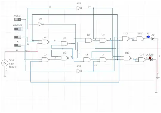

That is correct. There is no way to know how the circuit would proceed.
To fix this we can use an asynchronous or synchronous RESET or PRESET input to set the output to a known state. An asynchronous input does not depend on the clock, but a synchronous input depends on the clock.
Here is a reference circuit for a Master-Slave JK Flip-Flop with asynchronous reset and set inputs.
JK Flip-Flop with Asynchronous RESET and SET input
JK Flip-Flop with Asynchronous RESET and SET input simulate this circuit - Schematic created using MultisimLive
This is the circuit of a JK Flip-Flop with an asynchronous RESET and PRESET. A HIGH on an asynchronous RESET input sets Q to LOW and Q' to HIGH, and this operation is independent of the clock. Similarly, a HIGH on an asynchronous PRESET input sets Q to HIGH and Q' to LOW.
Working:
When the RESET input is HIGH, the output of the NOT gate (U11) will be LOW. The output of the NAND gate (U12) will become HIGH since one of the inputs is LOW. This will make the output of the NAND gate (U13) Q to be set to LOW. Similarly, other cases can be analysed, and is left as an exercise to the reader.
Note:
Behaviour is not defined for the case when both PRESET and RESET are HIGH, since it is not allowed (and meaningless).
