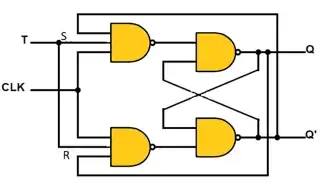

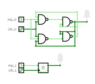

I've been playing with a few logic simulators and don't understand why flip-flops are not working. I'm trying to implement a T flip-flop with NAND gates:
All the simulators I've tried give the same result. Either Q or Q' takes the state of the clock rather than toggling on the rising edge, depending on the timing of the internal updates. Given the symmetry of the circuit I'm not that surprised, but wonder how it's meant to work in practice.
Is this even possible, or do these imulators provide flip-flop components because it's not possible to do with basic parts? If so, why and what is missing?
Simulators:
NAND gate circuit compared to a provided T flip-flop (circuitverse.org):
The same in simulator.io (using AND+NOT as there's no NAND):

Because from this page, the style that you show only works if the width of the clock pulse is tuned to be long enough for the output stage to react, yet short enough for the thing to not oscillate. A logic simulator that doesn't model propagation time may not be able to cope.
To simulate your circuit, you'd need a circuit simulator that 'understands' propagation delay, or you'd need to simulate your circuit at the transistor level.
That same page shows this circuit for a fully synchronous J-Kflip-flop (just connect J & K together for a T f-f):
You may want to try that in your simulator, see what happens.

The circuit you show is a gated JK latch, not a flip-flop. It suffers from a flaw: with T high and clock high, the cross-coupled NAND gates form a ring oscillator. This is sometimes called the ‘race-around’ problem. The output never settles until the clock is brought back low.
This circuit is illustrative of how not to make a clocked flop. Otherwise it’s useless. An actual toggle flop will use a pair of latches in two stages, clocked on opposite levels. This is sometimes called an ‘edge-‘master-slave’ flip-flop. The variant using a trio of latches (6 gates total) is called 'edge triggered’. Either way, these don't suffer the 'race around' flaw.

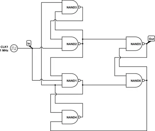

To implement an edge triggered T Flip-Flop that does not rely on gate delay timing, requires, I believe, a minimum of 6 Nand gates. The circuit below simulates fine in CircuitLab.
schematic
Edit:
Someone has commented that this circuit is not a T flip-flop because the circuit depends upon the clock alone, and does not have separate T and clock inputs.
However, when I google "T flip-flop", the very first hit that comes up for me is this which states:
The T or "toggle" flip-flop changes its output on each clock edge, giving an output which is half the frequency of the signal to the T input.
It is useful for constructing binary counters, frequency dividers, and general binary addition devices. It can be made from a J-K flip-flop by tying both of its inputs high.
and which contains the graphic:
I don't claim that this is necessarily an authoritative refutation of the claim that a T flip-flop must have separate T and clock inputs. (There is certainly a lot of misinformation about flip-flops on the interwebs. For example, the OPs circuit, shows up all over the place labeled as a T flip-flop despite the fact that it has problems described in other answers.) However, I am offering the above information as an alternative point of view to that of the commenter.
Edit2: A commenter has asked for a state diagram for the circuit. I will provide this information, but not as a diagram.
There are 4 stable states and 12 states that are transistional between stable states in normal operation.
The stable states are:
State: Vin N1 N2 N3 N4 N5 N6
S1: 0 1 1 0 1 1 0
S2: 1 0 1 0 1 0 1
S3: 0 1 1 1 0 0 1
S4: 1 1 0 1 1 1 0
The transitions go as follows
S1 In\$\uparrow\$ N1\$\downarrow\$ N6\$\uparrow\$ N5\$\downarrow\$ S2
S2 In\$\downarrow\$ N1\$\uparrow\$ N4\$\downarrow\$ N3\$\uparrow\$ S3
S3 In\$\uparrow\$ N2\$\downarrow\$ N5\$\uparrow\$ N6\$\downarrow\$ N4\$\uparrow\$ S4
S4 In\$\downarrow\$ N2\$\uparrow\$ N3\$\downarrow\$ S1

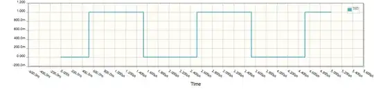

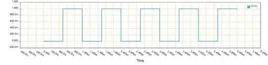

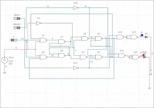

For reference, I've built a T Flip-Flop with asynchronous inputs using a Master Slave JK Flip-Flop, which you can simulate in your browser:
T flip-flop simulate this circuit - Schematic created using MultisimLive

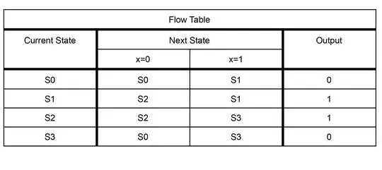

The circuit in the original question contains 1 or more hazards or race conditions. As such, the circuit will only work properly if the delays within the circuit are properly controlled.
An asynchronous finite state machine with hazards (or race conditions) will, in general, work properly only if delays within the circuit are properly controlled. An asynchronous finite state machine without hazards (or race conditions) or with hazards which are "covered" (and hence not active) will perform properly if there is at any time only one signal which is changing, and which does not receive new inputs until the circuit has reached a stable state.
Such asynchronous finite state machines may be implemented in a number of ways, but one way to do so is with a sum-of-products combinatorial circuit with some of the outputs fed back as inputs.
In this answer, such a circuit will be shown. However, it is probably unfamiliar to many, and is certainly less familiar than other implementations of T flip-flops, such as the master-slave implementation, or the 6 nand gate implementation shown in another answer.

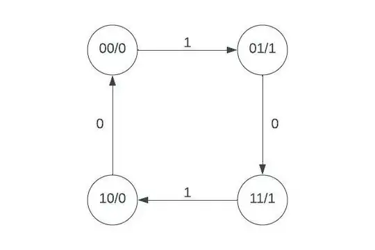

We start with an asynchronous finite state machine that we wish to implement:
The flow table for this state machine is given as:
We can assign variables and values to the states to give:

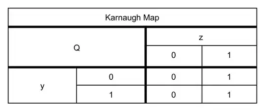

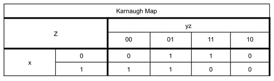

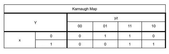

The Karnaugh maps for Q, Y and Z are given as follows
If we were attempting to find the minimal implementation of a boolean function, we would calculate a minimal sum of prime implicants that cover the function under consideration. However, such a procedure would allow our implementation to have static 1 hazards. To avoid static 1 hazards, we use extra prime implicants (in this case all of the prime implicants). This gives our combinatorial functions
\$Q = z\$
\$Y = x'z + xy + yz\$
\$Z = x'z + xy' + y'z\$
