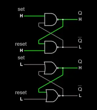

My question is that "Will SR Flip-flop made with NOR gates and NAND gates return the same results?" I do know that if we make SR Latches with NOR gates (let's say that this latch is called A) and if we make SR Latches with NAND gates (let's say that this latch is called B), the result of A and B are quite different. As it is mentioned here: SR Flip-Flop: NOR or NAND?. Also I do get that the diagram notation between both A and B latches are quite different in circuit diagrams. (I do know the main difference between latches and Flip-flops)

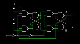

So, I would like to ask, "Will SR Flip-flop made with NOR gates and NAND gates return the same results?" and also in a similar manner, "Will JK Flip-flop made with NOR gates and NAND gates also return the same results?" (Since I was not able to find JK FF as well)

NOR and NAND SR Latches
The NAND-based flop will set and reset based on the falling edge of an input. The inputs are considered active-low.
The NOR-based flop will set and reset on the rising edge of the input. The inputs are considered active-high.
Try them here: NAND, NOR SR latch sim in Falstad
JK Latches
As you saw, there are a number of ways to make a JK latch. However, every single one of them has a hazard: oscillation when both inputs are active. All the diagrams that show some kind of pulse detector? Forget them, they're useless except as object lessons in how not to make a latch. More about that here: JK latch, possible Ben Eater error?
Here's a sim of a correct JK flop using a master-slave pair:
JK with master-slave latches in Falstad

  • Thank you so much for your detailed information, also thank you for a great circuit simulation website. So, I guess the main difference between NAND SR FFs and NOR SR FFs are the clock timing(rising and falling) it is active rather than output by SR inputs. My professor introduced latches and flip-flops in quite confusing manner, so I needed some confirmation. Thanks again for your help! – Gooday2die Jun 18 '20 at 05:39
