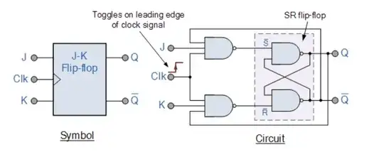

Im trying to implement a jk flip flop gate level in verilog using nand gates but for some weird reason i dont get a proper output.
Schematic of JKFF
Here is my jk flip flop module:
module jk_flip_flop(q, q_bar, j, k, clk);
output q, q_bar; input j, k, clk; wire j_star, k_star;
nand(j_star, q_bar, j, clk);
nand(k_star, clk, k, q);
nand(q, j_star, q_bar);
nand(q_bar, q, k_star);
endmodule

  • "Please correct my code"...sorry, that is not how this works. You need to show us that you have made a substantial effort to solve this yourself. In this case you have a simulation so you can check the state of internal nodes. What do j_star and k_star look like? Do you have a truth table for this circuit, so you know what to expect? – Elliot Alderson Feb 27 '22 at 16:35
You don’t actually have a flip-flop. What you have is a gated jk latch.
When all three inputs are high, the latch will oscillate. This is due to the feedback path formed from the outputs to the pair of gates on the input.
More here: JK latch, possible Ben Eater error?
That said, your test bench never toggles clock. Is that your intention?
