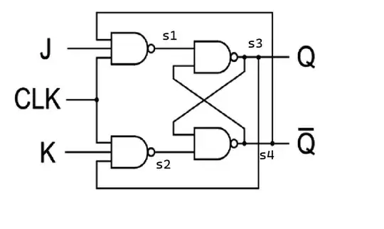

I want to write code and simulate waveforms for flip flops strictly using dataflow modelling. In this case I'm simulating a jk flip flop with only j,k and clock (no set , reset). It compiles fine, but when I try to simulate run the waveforms (j,k,clk,q,qbar), my modelsim stops responding. I guess it has something to do with using output as input, as I'm not well versed with sequential circuits in vhdl but combinational circuits seem doable.

   s1 <= not(j and clk and qbar);
   s2 <= not(k and clk and q);
   s3 <= s1 nand qbar;
   s4 <= s2 nand q;
   q <= s3 ;
   qbar <= s4 ;
end dataflow;
my circuit with signals enter image description here

    You have a combinational feedback loop. Synthisers will flag it as DRC error and you won't able to use this "unpredictable" logic on an actual board. Not sure what you are trying to achieve with this code. And of course if it's for simulation purpose only, then you have infinitely triggered concurrent statements. – Mitu Raj Feb 25 '21 at 12:17
    Feedback with negation and zero delays means you get delta cycle oscillations where each delta cycle causes another until you hit the iteration limit. Some FPGA synthesis tools won't balk when synthesizing feedback loops. Preventing oscillation requires tuning delays or using a pulse derived from a clock edge. Alternatively you can use a master-slave flip flop. –  Feb 25 '21 at 23:07

    @AyushSinha Hey, addressing the question, which is about the Modelsim freezing. I tried to reproduce it as you intended, without a tesbench by changing inputs of your jkff_data in the waveform, but it looks to successfully simulate for me. It gives undesired unknown values at the outputs, but it is another question, I guess. So could you give some more details, what leads to Modelsim freezing (software version, compilation options, etc.)? Moreover, is it still a problem? – megasplash Mar 03 '21 at 09:09
  • @megasplash , Did you use the exact same code that is in my original post? What I do is I start it's simulation then add all the signals to the waveform. Then I clock the clk variable and start forcing j,k to diff values to get o/p as q and qbar. What is your process of forcing, clocking without testbench? – Ayush Sinha Mar 03 '21 at 14:07
    This is not the circuit of JK F/F. This is JK Latch's circuit. In popular naming convention, F/F are classified as edge triggered and Latches as level triggered. This is a level triggered latch. – Mitu Raj Mar 03 '21 at 15:13
  • @AyushSinha Yes, exactly that. You write in a comment to the answer, that simulation gives you the results. So do you still have a problem of freezing Modelsim? – megasplash Mar 03 '21 at 15:52
Note: The circuit you are using is not the correct one. See JK latch, possible Ben Eater error?

  • @AyushSinha that is not a jk ff. The first one is a jk latch with a reset – Shashank V M Mar 03 '21 at 13:56

  • I simulated and got this. It is a latch(level triggered) as one user pointed out. https://ibb.co/WKMzFNh But at some points it doesn't seem to give correct outputs, like j = 0, k = 1 and q = 1. Is it expected? – Ayush Sinha Mar 05 '21 at 17:49
  • @AyushSinha build a level triggered latch using behavioural modelling and then see if its outputs match what you are building – Shashank V M Mar 07 '21 at 15:19
