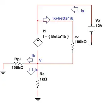

The update was added to post. The schematic that I use for "ro" derivation is presented below. The equations that I derivate are:
vx = (ix + betta * ib) * ro + v; v = ix * (Re||Rpi); ib * Rpi = (ix - ib) * Re;
May anyone check them?

For this equivalent circuit:
$$V_X = (I_x +\beta I_B) r_o + V$$
Additional we know
\$V = I_X \cdot R_E||r_\pi = I_X \cdot R_X\$ and \$I_B = \frac{V}{r_\pi} = \frac{I_X \cdot R_X}{r_\pi}\$
Therefore
$$V_X = (I_X + \frac{\beta\:I_X \cdot R_X}{r_\pi})ro + I_X \cdot R_X$$
$$V_x = I_X \left( \frac{\beta \cdot R_X \cdot ro}{r_\pi} + ro + R_X \right)$$
And finally
$$R_{OUT} = \frac{V_X}{I_X} = \frac{\beta \cdot R_X \cdot ro}{r_\pi} + ro + R_X = ro \left(1 + \frac{\beta R_X}{r_\pi} \right) + R_x$$ $$= ro+ \left(1+\frac{\beta}{r_\pi} \cdot ro\right)\cdot R_E||r_\pi $$

  • I forget, why we suppose that ib is equal to zero? Forgot why in second equation V = Ix * Re||R_pi, we think that only Ix will be on Re in parallel with R_pi? – MaxMil Feb 04 '18 at 15:36
  • @MaxMil But we are not forgetting about the base current. The "arrow" on the diagram you made is not accurate enough. Ib = V/R_pi and IRe = V/Re hence Ix = Ib + IRe and V = Ix*Re||R_pi – G36 Feb 04 '18 at 15:44
