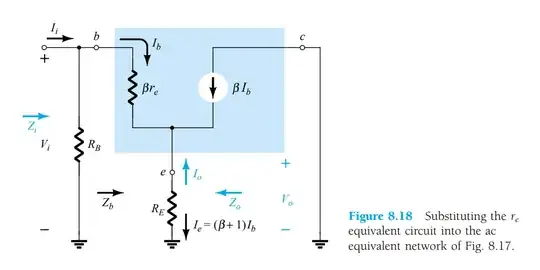

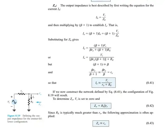

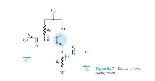

We've to calculate output impedance of the circuit (figure 1). Although i understood the textbook solution (figure 2, figure 3), I took a different approach and arrived at a wrong answer.
step 1: I shorted the input voltage sources. (since, Zout is being calculated)
step 2: since there is no power anywhere in circuit, Ib will definitely be 0.
step 3: the dependent source is opened. (since, Ib = 0)
step 4: also RB is shorted by the source
step 5: thus, when seen b/w emitter terminal and ground, βre and RE are parallel but equation 8.42 says otherwise!
please point where the mistake was in my approach.

  • No. Current flows (conventional flow) from Vcc through Rb, through the E-B junction, through Re, to Ground. In other words, the transistor has base bias. The amount of bias current depends on the value of the resistors. – Dwayne Reid Mar 29 '19 at 19:18

  • Ib = -Ve/($\beta$Re) – Spehro Pefhany Mar 29 '19 at 20:21

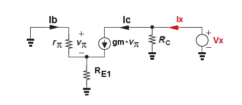

To be able to see the difference try to analysis these two circuits.
The first one is CE amplifier
And for this circuit
\$Z_{OUT} = \frac{V_X}{I_X} = R_C\$
because \$I_B = 0A\$
But for the emitter follower, we have a different situation:
And \$ I_B\$ is not equal to \$0A\$ despite the fact that the Vin = 0
For this circuit \$I_B = -\frac{V_X}{r_{\pi}}\$

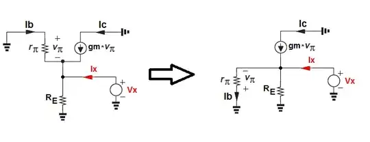

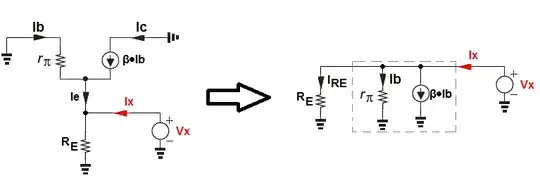

Let us try to find the \$Z_{OUT}\$ for the equivalent circuit:
I hope that you see that \$R_E\$ is in parallel with the resistance seen from the emitter terminal into the BJT.
And our test current is
$$I_X = I_B + \beta I_B + I_{RE}$$
But if we ignore \$R_E\$ resistance for a moment we can find the transistor resistance seen from the emitter looking into BJT.
$$I_X = I_B + \beta I_B = I_B(\beta +1)$$
Additional we know that \$I_B = \frac{V_X}{r_\pi}\$
we can write
$$I_X = I_B(\beta +1)= \frac{V_X}{r_\pi}(\beta +1) = \frac{V_X (\beta +1)}{r_\pi} $$
$$\frac{I_X}{V_X} =\frac{\beta +1}{r_\pi} $$
And finally
$$Z_{OUT} = \frac{V_X}{I_X} = \frac{r_\pi}{\beta +1}||R_E $$
and because
$$r_\pi = (\beta +1)re $$
we have
$$Z_{OUT} = re||R_E $$
