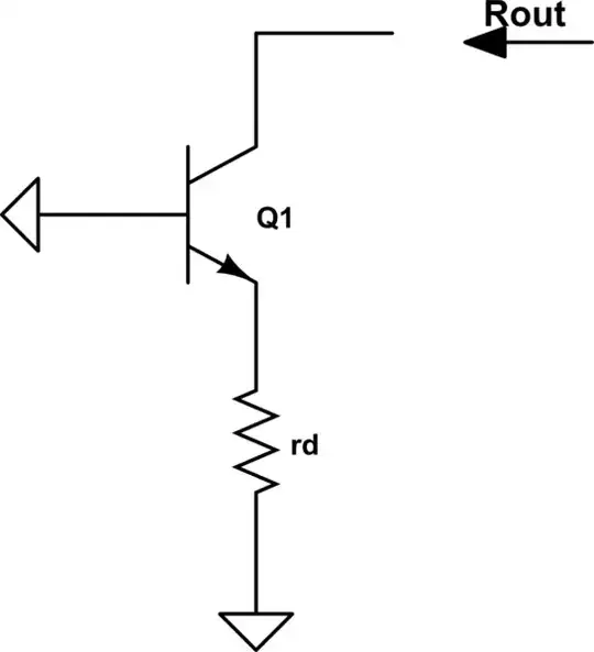

Like for instance, the picture above. How to find the output impedance?
My thought was like draw the small signal circuit of them, then do the equivalent. But I am not sure if I need to short the current source of Q2 or not. I know that for Q1, I need to short the current source, cause Vbe for Q1 is zero. What should I do? Thank you.

You don't have to short anything. In this schematic from a book (Behzad Razavi).
The GND symbol represents the AC ground, not a DC ground. Therefore you must assume that both transistors are properly biased. All, you need is to replace all transistor with the corresponding small-signal model and do the calculations.
Additional to simplify a thing notice that Q2 is work as a diode connected BJT.
And (I assumed that you read the book) you should know by now that the small-signal equivalent circuit for Q2 is a single "resistor" rd:
\$r_d = \frac{1}{gm}||r_\pi||r_o \approx \frac{1}{gm}\$
Hence your circuit reduced to:
schematic
