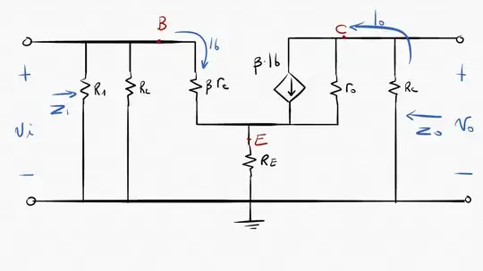

I try to solve Zout for this BJT small-signal model but I find
RC || (ro + RE)
because Zout is calculated with Ib = 0 => βIb = 0.
From this link too Vin was calculated.
But the expression for Zo given in the book by Boylestad and Nashelsky is:
Zo = RC || (ro + β (ro + re) / (1 + β re / RE)])
Can you explain how to derive this?

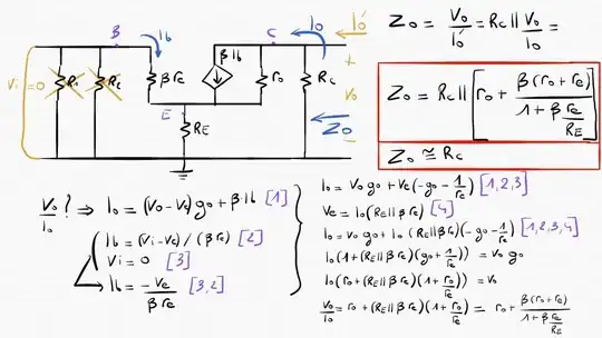

Solution : Vi = 0 not => ib = 0 enter image description here
  • compare it with my solution https://electronics.stackexchange.com/questions/265046/calculation-of-output-impedance-of-ce-emitter-bias-configuration-unbypassed-wi/276764#276764 and here https://electronics.stackexchange.com/questions/342859/bjt-common-base-output-resistance-derivation/342989#342989 – G36 Jun 15 '20 at 13:10

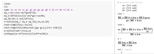

If you put the equations correctly:
point C :   io vo ve ib
point E :      vo ve ib
ib def  :         ve ib
3 unknowns : (vo OR io) AND ve AND ib
to get vo = function(io) OR io = function(vo)
