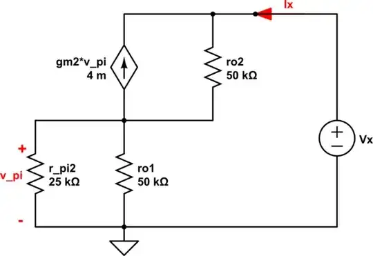

The first thing you should notice is that from a small-signal preceptive point of view \$Q_1\$ \$r_{o1}\$ act just like the emitter resistance for \$Q_2\$
And the small signal mode will look like this
schematic
The small-signal parameters are:
\$\large g_{m2} = \frac{0.1\textrm{mA}}{25\textrm{mV}} = 4\textrm{mS}\$
\$\large r_{\pi 2} = \frac{\beta}{g_{m2}} = 25\textrm{k}\Omega\$
\$\large r_{o2} = r_{o1} = \frac{V_A}{\textrm{I}} =\frac{5 \textrm{V}}{0.1\textrm{mA}} = 50 \$
Hence the output resistance will be the same as I show here:
BJT common-base output resistance derivation
finding output resistance of CB amplifier with ro
$$R_{OUT} = \frac{V_X}{I_X} = r_{o2}+\left(1+ g_{m2} r_{o2}\right)\cdot r_{o1}||r_{\pi2} = 3.4\textrm{M}\Omega $$

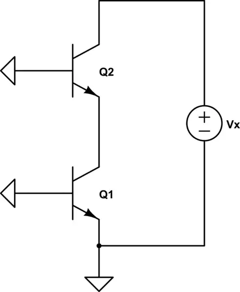

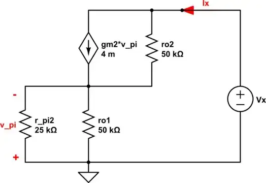

Also, remember that in the small-signal analysis you can replace PNP with the NPN small-signal model.
schematic
simulate this circuit
schematic

  • thank you very much for your answer. I would like to get some clarifications. I noticed that your model seems like the hybrid-pi model since you are using the r-pi. But my confusion now is, how could r_o1 which is in the emitter of Q2 be in parallel with r_pi2 which is in the base of Q2?? – JordenSH Jun 17 '18 at 15:01
  • could you please point me to where my mistake is in my analysis. I can't figure out where am going wrong?? – JordenSH Jun 17 '18 at 15:04
  • @Raykh but do you see that ro||re in your small-signal? And from where did you get this 2ro? Vo = ro(Io + gm vpi)+ ro I1 is equal to Vo = ro(Io+ gm vpi + I1)also you equation for vpi is wrong. It seems that you forget that I1 = Io - (gm Vpi)/β. So vpi = (β Io ro)/(β + gm ro) – G36 Jun 17 '18 at 16:03
  • Ah! you nailed it. It is this algebra mistake for vpi. Exactly, vpi = ( Io ro)/(1 + gm ro/β ). Thank you very much. A lot of insightful information I learned. I didn't know that for small signal analysis you can replace the PNP with NPN. Thank you very much. – JordenSH Jun 17 '18 at 17:15
  • given that now I know Ro and Rin for this folded cascode. Do you know a technique to find the gain Av using Ro and Rin?? or do I have to redo the small signal analysis all over again but for now to find gain?? – JordenSH Jun 17 '18 at 17:21
  • Well, Rin = r_pi1 and the gain is the same as for CE amplifier Av = gm*RL – G36 Jun 17 '18 at 17:26
  • because we have to stages Q1 is a CE amplifier with a gain equal to re2/re1 = 1V/V and Q2 is a CB stage. – G36 Jun 17 '18 at 17:27
  • thank you. But in general, do you know if there is a way to find the gain given Rin and Ro?? Also, for CE shouldn't Av = -gm*RL?? – JordenSH Jun 17 '18 at 17:28
  • Usually, we omit this "minus" sign because we know what this "minus" sign represents/means. This "minus" only informs us that the output voltage is the 180-degree phase shift with respect to the input voltage. Av _max = (βxRout)/Rin = (100 x 3.4MΩ)/25kΩ =13.6kV/V or gm x Rout = 4mS x 3.4MΩ = 13.6kV/V – G36 Jun 17 '18 at 17:38
