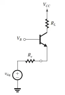

I have this CB amplifier circuit below

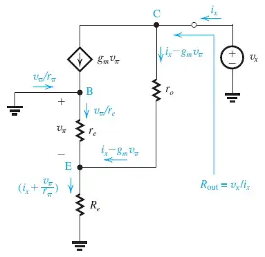

This is the small signal equivalent circuit arranged to find the output resistance R_out with the r_o included
Here is my analysis below to find the output resistance R_out
\begin{equation} v_x\:=\:r_o\left(i_x-g_mv_{\pi }\right)+R_e\left(i_x+\frac{v_{\pi }}{r_{\pi }}\right) \end{equation} \begin{equation} v_x\:=\:i_x\left(r_o+R_e\right)+\left(\frac{R_e}{r_{\pi }}-g_mr_o\right)v_{\pi } \end{equation} \begin{equation} v_{\pi }+R_e\left(i_x+\frac{v_{\pi }}{r_{\pi }}\right)\:=\:0 \end{equation} \begin{equation} therefore\:\:v_{\pi }\:=\:-\frac{r_{\pi }}{r_{\pi }+1}R_ei_x \end{equation} after some rearragements \begin{equation} \frac{v_x}{i_x}\:=\:R_{out}\:=\:r_o+R_e+\left(g_mr_o-\frac{R_e}{r_{\pi }}\right)\left(\frac{r_{\pi }R_e}{r_{\pi }+1}\right) \end{equation} I tried to manipulate my results but it does not come out to the same formula in the book which is below: \begin{equation} \frac{v_x}{i_x}\:=\:R_{out}\:=\:r_o+R_e\backslash \backslash r_{\pi }+\left(R_e\backslash \:\backslash \:r_{\pi \:}\right)g_mr_o \end{equation}
can somebody please tell what am doing wrong?? thanks in advance for all the help.

You made a mistake here
$$v_\pi+R_e \left( I_x+ \frac{v_{\pi}}{r_\pi} \right) = 0$$
Solve for \$v_\pi\$
$$v_\pi+R_eI_x+ \frac{R_ev_{\pi}}{r_\pi} = 0$$
$$v_\pi r_\pi + R_e I_x r_\pi + R_e v_{\pi} = 0$$
$$v_\pi r_\pi + R_e v_{\pi} = - I_x R_e r_\pi$$
$$v_\pi (r_\pi + R_e) = - I_x R_e r_\pi$$
$$v_\pi = - I_x \cdot \frac{ R_e \cdot r_\pi}{r_\pi + R_e} = -I_x\cdot R_x$$

Your dependent current source is in the wrong place in your AC equivalent diagram, it should be in parallel with r_o, going from C to E junction.

  • This is a screenshot from one of the most famous electronics textbooks, Sedra Smith. What are you talking about?? plus your reasoning is exactly what is on the diagram. – JordenSH Jun 02 '18 at 01:36
  • Accidents happen. If you look at the hybrid pi model even here on Wikipedia, you can see that the dependent current source in the equivalent circuit of a BJT goes between the C and E junctions, not C and B. – Avid Pro Tool Jun 02 '18 at 01:58
    But this is the T-model, and this is the convention used throughout the book so far. – JordenSH Jun 02 '18 at 02:02
  • @Raykh I don't have sedra/smith, nor have I read it. By "T-model" do you mean a linearized version of the "transport model" as shown here at three equivalent Ebers-Moll models of the BJT? Just curious. – jonk Jun 02 '18 at 02:43
  • @jonk these look like more of a device physics models. The T-model is another version for the hybrid pi model – JordenSH Jun 02 '18 at 03:10
  • either way looks like there was an algebra mistake when getting v_pi in the work you've shown. There should be an R_e in the denominator instead of that 1. – Avid Pro Tool Jun 02 '18 at 03:18
  • @Raykh No, device models are deeper and would involve things like current densities, variable doping profiles, etc., whether 1D, 2D, or 3D. The link I provided here are for large signal behavior models (meaning, non-linear) that work over a wide range. The hybrid-$\pi$ I mentioned there is the *non-linear* large signal model (before being linearized.) Many folks, not even aware of the fuller model, may write "hybrid-$\pi$" but actually would mean to say "small signal linearized hybrid-$\pi$" if they knew better. – jonk Jun 02 '18 at 04:10
  • I think @Raykh is referring to the T model described here in section 8.8. I'm not very familiar with it either and it threw me off since I'm used to small signal linearized hybrid pi. But I think it's just an algebra mistake here in the original question. – Avid Pro Tool Jun 02 '18 at 04:20
