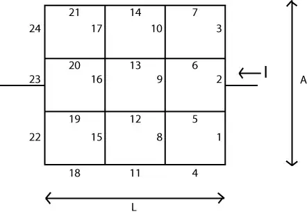

Disclaimer: I am a geophysicist with limited electrical engineering background. I am not sure if this problem is incredibly easy, incredibly complex, or completely nonsensical.
My goal: Determine the bulk resistivity of a rock sample using resistor networks.
The rock sample is to be modelled using a resistor network with certain resistors having high resistance(representing solid rock) and others resistors having low resistance (representing fluid pathways in the rock).
Suppose I have a network of resistors on a uniform grid as shown below. In the example shown, each line segment has an associated resistor labelled 1 through 24 on a 3-by-3 grid. The resistances of each line segment are known.
The total length of the grid is \$L\$ and the "area" is \$A\$ (in this case it is a 2-D example, so the area is also just a length). The bulk resistivity of the sample is then given by:
$$\rho_{bulk} = \frac{R_{eff}A}{L}$$
My question: How do I determine the effective resistance, \$R_{eff}\$ of the network?
I have looked online but all I can find are discussions about infinite networks, source and sink currents etc. I am not interested in the current or voltage.
Can this problem be solved as it stands?

    I would plug it into a simulator and let the simulator solve it. You can construct your model as a spice circuit. Then to find resistance, just use Ohm's law (V = I * R). Spice will tell you the current so you can calculate R. – user57037 Nov 28 '17 at 20:17
    The whole thing can potentially be automated using command line spice, but for proof of concept, you can enter your circuit in a free spice such as LTSpice. Apply a voltage, and display current. LTspice can also display simple functions such as a voltage divided by a current (resistance). – user57037 Nov 28 '17 at 20:21

  • Your sketch shows wires connected to the middle of resistors in two places. In modeling these grids, we electrical engineers only connect wires to the circuit nodes. – richard1941 Dec 02 '17 at 04:06

The basic idea is fairly simple. You arrange a matrix (\$V\$) that represents "nodes" or vertices in your system. Each of these nodes has a scalar-valued "voltage" associated with it that can be changed or updated as the algorithm proceeds. There will also be two nodes whose voltage cannot be changed. We are going to apply a "battery" of sorts here, so those two nodes represent the two ends of this battery.
Separately, another two matrices (\$Rv\$ and \$Rh\$) represents the edges in the system, horizontal and vertical. These are your resistance values, I guess. I'm not sure how you intend on filling these out. But that's your problem. This technique assumes you are able to populate these matrices, as well.
Depending upon the computer language you use, you may or may not be able to use negative indices. Doesn't matter. It's just a matter of keeping in mind what you are faced with.
Let's assume length \$L\$ is divided into \$N_L\$ sections and that "length" \$A\$ is divided into \$N_A\$ sections. Then you will need to construct a matrix with \$\left(N_L+1\right)\cdot\left(N_A+1\right)\$ vertices for the scalar voltage values. (or larger.) You will also need those other two matrices with \$N_A\cdot\left(N_L+1\right)\$ vertical edges and \$N_L\cdot\left(N_A+1\right)\$ horizontal edges between those vertices.
Now. Initialize all of the vertices with \$0\:\textrm{V}\$. Choose one of the vertices on the left (in the middle, preferably) and note it as a \$0\:\textrm{V}\$ value that is NOT allowed to ever change. Use whatever method you want for this. Choose one of the vertices on the right (in the middle, preferably) and change its value to \$1\:\textrm{V}\$, while again taking note that its value is NOT allowed to ever change. A technique that works here is to simply let it change normally but then replace the value each and every step. But it doesn't matter how you achieve this, so long as you do achieve it.
(There are other techniques for efficiency reasons. But it's probably not worth bothering with them here.)
Now for the algorithm, which is sometimes called a checkerboard or red-black algorithm. Moving through your node voltage matrix, process each node where the sum of the two indices, \$i+j\$ is even, performing the following simple assignment:
$$\begin{align*} V_{i,j}&=\frac{Rh_{i,j-1}\cdot Rh_{i,j}\cdot\left(V_{i-1,j}\cdot Rv_{i,j}+V_{i+1,j}\cdot Rv_{i-1,j}\right)}{Rh_{i,j-1}\cdot Rh_{i,j}\cdot \left(Rv_{i,j}+Rv_{i-1,j}\right)+Rv_{i-1,j}\cdot Rv_{i,j}\left(Rh_{i,j}+Rh_{i,j-1}\right)}\\\\ &+\frac{Rv_{i-1,j}\cdot Rv_{i,j}\cdot \left(V_{i,j-1}\cdot Rh_{i,j}+V_{i,j+1}\cdot Rh_{i,j-1}\right)}{Rh_{i,j-1}\cdot Rh_{i,j}\cdot \left(Rv_{i,j}+Rv_{i-1,j}\right)+Rv_{i-1,j}\cdot Rv_{i,j}\left(Rh_{i,j}+Rh_{i,j-1}\right)} \end{align*}$$
The above equation is nothing more than computing the voltage of a central node having four resistors connecting to it, where the voltages at the other ends of the four resistors are known. The central node voltage is then computed from the above equation. Since the divisor is the same for each term, you could just compute the sum of the numerators and then divide once by the denominator.
That will update all the nodes where the sum \$i+j\$ is even. Now you perform the same procedure to all of the nodes where the sum \$i+j\$ is odd. Once both these steps has been performed, you have completed one cycle.
If necessary, reset the special two nodes (for \$0\:\textrm{V}\$ and for \$1\:\textrm{V}\$ as earlier discussed.) Or, if you protected those two nodes, there's no need to reset them.
You are ready for the next cycle. Perform these cycles as many times as you feel is necessary for the overall state to settle down (and it will.)
When you stop the process, you can easily work out the resistance by either choosing to look at the nodes surrounding your left-side protected node or else look at the nodes surrounding your right-side protected node. (It may be a good idea to make your matrix just enough larger [by 1 in all directions] so that you will actually have four nodes surrounding either choice.) The difference in voltages between the surrounding nodes and the special node, divided by the resistance in the edges between them tells you the current leaving/entering your special node. Since this is a "battery" node, this current must be ALL of the current. Since the voltage is \$1\:\textrm{V}\$, by definition, dividing 1 by the sum of these four currents you find tells you the total resistance.
I'm staring at some code I wrote that totals, with lots of comments, just 67 lines. So it's NOT hard to write.
The "short summary" of this idea is that you apply a \$1\:\textrm{V}\$ battery and then watch as the voltages spread throughout the system. Once the voltages stabilize (your criteria for that), all you have to do is look at the current coming into, or out of, one battery terminal or the other one. They should both be the same current value (within some numerical bounds) for obvious reasons.
Why is it that you must separate the system into i+j = even and i+j = odd?
Suppose you compute \$V_{5,5}=f\left(V_{4,5},V_{6,5},V_{5,4},V_{5,6}\right)\$. This references the nodes that surround \$V_{5,5}\$. That's fine. Suppose you next compute \$V_{5,6}=f\left(V_{4,6},V_{6,6},V_{5,5},V_{5,7}\right)\$. Note that in the list of parameters is the value you just computed for \$V_{5,5}\$? This would "smudge" things a lot. It's not sound. Instead, each cycle of odd/even should "appear as if" it occurred at the same moment. So your next computation should be \$V_{5,7}=f\left(V_{4,7},V_{6,7},V_{5,6},V_{5,8}\right)\$ because none of the inputs to the function are nodes that were changed during this step. Then you swing around and compute the alternates, avoiding the smudging but now updating the alternates. You really do have to do it this way.
Also, is the formula identical for both even and odd steps through?
Yes, it's the same.
Can it all be solved in one step using some sort of linear system Ax=b where A is a linear operator and b provides the boundary conditions? Looking at it, it seems somewhat analogous to finite difference methods for solving partial differential equations..
There is a connection. I think it's called a 'matrix-free' implementation.

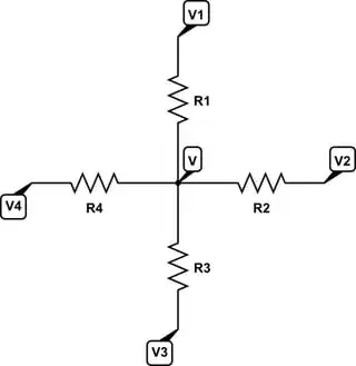

The derivation is pretty simple from KCL. Place four resistors into the following arrangement:
schematic
Apply KCL:
$$\begin{align*} \frac{V}{R_1}+\frac{V}{R_2}+\frac{V}{R_3}+\frac{V}{R_4} &= \frac{V_1}{R_1}+\frac{V_2}{R_2}+\frac{V_3}{R_3}+\frac{V_4}{R_4}\\\\ &\therefore\\\\ V &=\left(\frac{V_1}{R_1}+\frac{V_2}{R_2}+\frac{V_3}{R_3}+\frac{V_4}{R_4}\right)\bigg(R_1 \mid\mid R_2 \mid\mid R_3 \mid\mid R_4\bigg) \end{align*}$$
Some playing around with algebra gets the result I used in the code.
