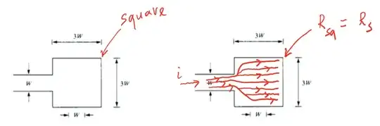

The first figure shows the layout of a metal wire and current flowing in the metal from left to right.
Assume that that the sheet resistance of the metal is Rs (Ω/sq) then the resistance of the square 3W x 3W with such current flowing is just same as Rs, the sheet resistance of the metal.

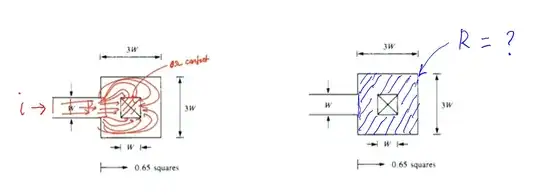

Now consider the case where there is a zero-ohm contanct in the center of the square. The current flows from left side to the square and entering the contact from all directions and then though the contact to the bottom layer.
So I'm trying to calculate the resistance of the blue part if current flowing in all directions to the contact as shown in the image.
The result is 0.65*Rs but I would like to know if there is a general approach to prove this. I heard that it can be done by using integral but I haven't figured out how to do that.

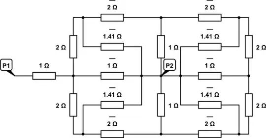

  • By creating a resistor network with a finite number of resistors that have values that roughly resemble the distances between their endpoints. Start with the centers of each of the eight squares around the pin. That gives you ten nodes and 17 resistors. – Janka Sep 22 '21 at 12:53
  • @Janka I still don't quite get it. How close am I? https://ibb.co/9pxj5TD – emnha Sep 22 '21 at 19:25
  • Not very close. I write you an answer. – Janka Sep 22 '21 at 20:27
  • One of the things that throws me with this question is where are you wanting to calculate the resistance from and to? Normally resistance is from a single point to another point. But it almost sounds like you want to measure the resistance from an outer equipotential outline to an inner equipotential square. In any event, I think the question would be more clear if you somehow specify exactly what resistance it is that you want. – user57037 Sep 23 '21 at 03:57
  • @mkeith would it be clear now? – emnha Sep 23 '21 at 06:23
  • If that is really the problem, I don't think there is going to be a simple solution. If you imagine that the perimeter of the 3W square is all at the exact same voltage, and the current flows toward the small (WxW) square, then I expect you could set up a simple integral and solve it. But if the current enters the big square from the trace, well, it is going to be more complicated like everyone is saying. Not a simple integral. – user57037 Sep 23 '21 at 06:52
  • @mkeith yes, it's from the trace to the square. – emnha Sep 23 '21 at 07:09
You need to model this with finite elements. That means you create a resistor network with a finite number of resistors that have values that roughly resemble the distances between their endpoints.
For example, start with the centers of each of the eight squares around the pin. That gives you ten nodes and 17 resistors.
schematic
As you can see, it gets quite tedious to solve this by hand. That's why there's computer programs that do it.

  • You have two nodes. One is the edge of the square where it touches the track to the left. The other is the pin. I chose that particular network topology above because it gives you a rough figure about the result resistance on first look. It must be somewhat around 0.75Ω (per unit). You can chose any other topology as well as long as you change the resistor values accordingly. – Janka Sep 24 '21 at 15:18
  • The contact is of zero ohm resistance so it's an equipotential node. However, how do you know that all points on the edge where the current enters on the left are of same potential? – emnha Sep 24 '21 at 17:57
  • I simulated your model and got the equivalent resistance of the whole circuit is 1.5945 ohms and the resistance of the square part is 0.5945 ohms. The result is good but I still want to prove the exact value. – emnha Sep 24 '21 at 20:52
  • It's only a very simple model. Don't expect models to be more than 10% accurate. Reality usually has effects you haven't even thought about, for example non-neglible unlineareties. – Janka Sep 24 '21 at 22:15
