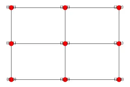

I am modeling a mechanical process by using an electrical analogue. I need to calculate the loop (mesh) currents, then I can see if any mesh current is greater than a predetermined value \$\lambda\$. There are voltage bars connected to the top, and the bottom is connected to GND. Initially the voltage, \$_{VCC}\$ is 10V. Each edge is a \$ 1 \Omega \$ ideal resistor.

Rectangular grid of resistor, coordinates on nodes
So if you look a the picture above there should be four loops, but networkx, a graph theory based library for python3, returns using nx.cycle_basis(G):

  • @Lewis I'm not familiar with the software you're using, but a better drawing may help you think about this. If GND is on the bottom rail, there is no resistance between the nodes with GND applied. Similarly, if the voltage is applied between 0,2 and 0,1, either 0.2 and 0,1 are connected with 0 ohms, or there is a node between them. If you redraw the circuit with VCC at the top and GND at the bottom, you'll see resistors start just running clearly in parallel, and therefore reducing, particularly since you have the same resistance and therefore no current flow between parallel paths – pscheidler Dec 21 '17 at 22:12
  • @pscheidler I agree with what you said but there are horizontal resistors running in parallel too because each edge has a resistor on it. Not sure if your method will still work? – Lewis Dec 21 '17 at 22:31
  • Please draw a three by three grid showing all resistors and where the voltage is applied. – user57037 Dec 22 '17 at 03:59
