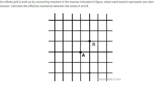

The answer given is 2/3ohm solution is not given but I can expect how they got that answer but can't justify the way.

However, the answer is not \$\frac23\:\Omega\$ as you appear to have found somewhere; rather, it's \$\frac2{\pi}\:\Omega\$.

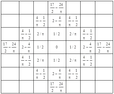

Here's a table replicated from the the first of the two above links I mentioned (I believe this is a fair use of the author's work):

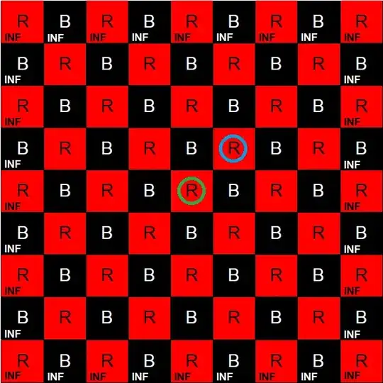

There are a number of numerical approximation techniques for this kind of problem. These include Jacobi and Gauss-Seidel. But another technique is found in the literature called the red-black successive over-relaxation method. I just call it the checkerboard method because that's what it looks like.
Here's an example that illustrates your case with a small (too small, really) grid:
The perimeter of the grid is surrounded with some "special value" used to indicate the perimeter or boundary. I'm showing INF as the value there. But any recognizable value is okay to use. (You don't include those as part of the computational process, which is why you use a special value here.) Also, the green and blue circles show where you have two special locations in the grid for your particular problem. (The blue circle could be placed at any of the four corners adjacent to the green circled square.) Those special locations will be given the value 0.0 and 1.0, which will never be allowed to change. Think of it as if you are applying a battery voltage between those two points with the green circled center being "ground" and the blue circled center being \$1\:\text{V}\$. (The remaining cells in the grid might be provided with a value half-way between, or 0.5, to help reduce the number of iterations needed to reach some precision goal.) Your resistors (not shown here because I was too lazy) connect the centers of each of the grid boxes. And for realistic results, your grid will need to be a lot bigger than shown above.
Note that the numerical process alternates by processing first the red squares (or black) because doing so only looks at the black squares (or red) to compute the next iteration's value for each cell. Alternating like this avoids the problem of smearing (which you do not want.) It also makes this technique work extremely well with parallel processing, because all of the red (or black) square values being computed can be performed entirely in parallel across the entire grid with enough processors or threads to do it. Just loop over the matrix performing a checkerboard (red and black squares) set of calculations (either red squares first, then black squares, or else visa versa.)
In this simple case (easy partial differential), the calculations for each square is just the average of the four surrounding squares: above, below, left, and right. However, as mentioned earlier, you must make sure that you never alter the two locations that hold those special values of 0.0 and 1.0.
The loop ends either with some specified number of iterations or else when the sum of the four squares surrounding the value 0.0 doesn't change much (stays unchanged by some difference you decide on.) Then just print out your uniform resistor value divided by that sum of the surrounding four squares as the equivalent resistance.
