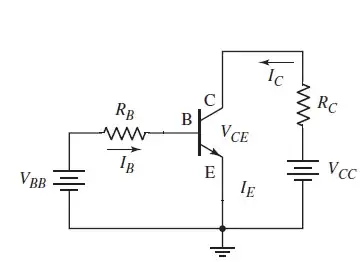

In Ebers-Moll Equations for common emitter BJT the inverse saturation current \$I_s\$ appears as a parameter. What is the saturation current \$I_s\$ exactly and how should I measure in a common emitter BJT (like the one in picture)? enter image description here
More precisely there is an approximation of the model where the current \$I_{ES}\$ appear : $$\displaystyle {I_{\text{E}}=I_{\text{ES}}(e^{\frac {V_{\text{BE}}}{V_{\text{T}}}}-1)\\I_{\text{C}}=\alpha _{F}I_{\text{E}}\\I_{\text{B}}=(1-\alpha _{F})I_{\text{E}}}$$ The first equation is simply the diode model for the junction BE and that current \$I_{ES}\$ should be the reverse saturation current of the base–emitter diode. So can I measure it by simply doing the following steps?
  • Invert generator VBB (to get reverse bias of BE junction)
  • Put ammeter in series with Rb and measure the current \$I_{ES}\$
If this is the case, can the junction CB be reverse or non reverse biased? Does it make any difference on \$I_{ES}\$?
(A secondary doubt is about the parameter \$\alpha_F\$, the common base forward short-circuit current gain: is it easily measurable or should it be read on the datasheet of the BJT model used?)
Nevertheless in the complete Ebers-Moll model there is \$I_S\$, which is simply defined as saturation current. Is it still the inverse saturation current of the BE junction? How to measure this current?

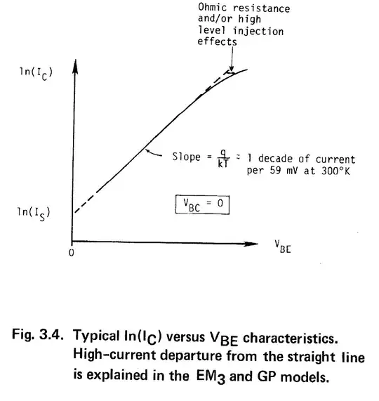

Plot the logarithm of \$I_C\$ on the y-axis. Plot \$V_{BE}\$ on the x-axis. Here's an example from "Modeling the Bipolar Transistor," by Ian Getreau:
Modeling the Bipolar Transistor, Figure 3.4
That should give you an idea or two about how you can arrive at a measured value.

  • Sorry, why not just connect the base to collector for $$V_{BC}=0$$? (To prevent deep saturation a diode between base and collector is used in some switching circuits.) – skvery Feb 19 '17 at 07:13
  • Thanks for the answer, therefore $I_S$ can be taken from extrapolation of the curve $$I_C=I_S (e^{\frac{V_{BE}}{V_T}}-1)$$ (linearized).Nevertheless $I_S$ is not something that can be mesured directly (with an ammeter for istance), correct? In other words, it is not the inverse saturation current of one of the two junctions (BE or BC),right? If I do the process I described in question I directly measure $I_{ES}$ with ammeter, so can I get $I_S$ from $I_S=\alpha_F I_{ES}$? – Sørën Feb 19 '17 at 13:55
    @Sørën Most measurements in life aren't directly measured, but involve some kind of deduction from theory. Not that different here. The description I gave is how it is measured by curve tracers and semiconductor test systems (in brief.) $I_S=\alpha_F \cdot I_{ES} = \alpha_R \cdot I_{CS}$ for the injection model terms, yes. – jonk Feb 19 '17 at 15:22
