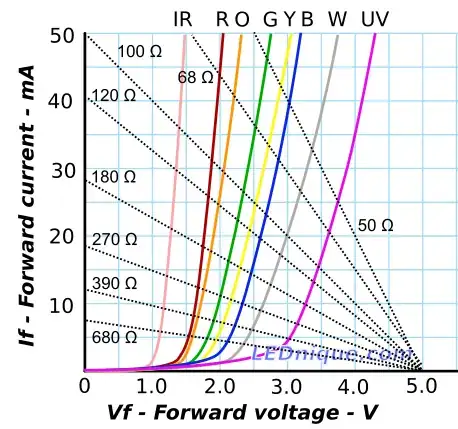

If you have a graph of current versus voltage for a diode you can draw "load lines" on them to solve your question. Here's one I had created for LEDs running from a 5 V supply. The voltages are higher than for a regular diode but the principle is the same.
Figure 1. The simple circuit.
Figure 2. Current versus forward voltage for a range of LEDs of different colours with load lines for various resistor values. Source: Loadline resistance graphic tool.
If we take the 100 Ω case of Figure 2 and the UV LED (because it is closest to the 5 V supply voltage) we can make the following observations:
  • If Vf is 0 V then there is 5 V across R1 and the current would be 5/100 = 50 mA. The 100 Ω load line starts at (0, 50).
  • If Vf is 5 V then there is 0 V across R1 and the current would be 0 mA. The 100 Ω load line ends at (5, 0).
  • To see what current flows through the UV LED on a 5 V supply with 100 Ω for R1 just find the intersection of the load line with the UV curve. This is at 3.5 V and 15 mA.
  • Given either the resistor value or the desired current you can quickly estimate the other from the graph.

If a diode is in series with a resistor and a voltage source that is set at the exact forward voltage drop value of the diode, what will be the voltage drop across the resistor?
Hopefully it's clear now that a diode doesn't have an "exact" forward voltage drop.
It can’t be zero but I’m guessing it must be close. We have learned that normally you would subtract the forward voltage (0.7 V) from the loop but this circumstance doesn’t make sense to me.
Your hunch is correct. You just need to remember that the current versus Vf graph is a curve, not a right angle.

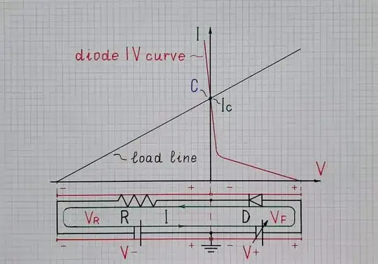

The problem here is that OP thinks the voltage drop across the diode is VF (about 0.7 V); so, including a voltage source with the same voltage VF, the result should be zero. However, this is valid if sufficient current flows through the diode (e.g., it is a basic requirement for a Zener voltage stabilizer)... and this requires higher supply voltage, which in this case is nowhere to be taken. As a result, as professionals say, "the diode is not properly biased". I have graphically illustrated this situation in Fig.1. Let's examine it.
Fig. 1 - Unbiased diode
Fig. 1. To work properly in the vertical part of its IV curve, the diode should be properly biased
To work properly (in the almost vertical part of its IV curve), the diode requires more significant current (IB) that can be obtained by higher voltage V and the resistance R. As a result, the load line (in brown) intersects the diode IV curve in the middle of the vertical part - the so-called "operating point" B, and the voltage drop across diode is VF = 0.7 V.
However, the OP's input voltage is only VF. So the load line has significantly moved to the left... and now it intersects the diode IV curve in the (almost) horizontal part of the IV curve - point A (the operating point has moved from the B to A position). Now the current IA is insufficient... and the voltage drop across diode is less than VF.
So, formulated in this way, the question has no practical value. It is just an undesired situation in the analog diode applications. But if somehow the diode is properly biased, the OPs question makes sense and can illustrate many interesting and important applications.
"Biasing" simply means "adding" constant voltage to the existing input voltage (V+ in the figure). If there was not a ground, there would be only one way to do it. But as we usually ground the diode (as in the figure), we can do it in two possible ways - from the side of anode ("pulling" it up) and from the side of cathode ("pulling" it down). Let's consider the latter as more interesting and more easily implemented - Fig. 2.
Fig. 2 - Biased diode
Fig. 2. Biasing a diode from the side of cathode
To bias the diode, we have connected another (but negative) voltage source V-. As we can see from the voltage picture (red bars), we can adjust V+ to make it equal to VF of operating point C (in the middle of the vertical part). As a result, the "output" voltage (of the cathode) is zero (the so-called "virtual ground"). As though the voltage V+ has neutralized the voltage drop VF across the diode... and the total voltage of this network consisting of V+ and D is zero. Figuratively speaking, we can think of the network as of "ideal diode" with zero voltage drop VF. Moreover, with more imagination, we can consider the voltage source V+ as a kind of "negative diode" -D that removes the "positive diode" D. It is negative since it adds voltage while the ordinary diode is positive since it subtracts voltage.
The name of this technique (can be) "voltage compensation"... where we compensate an undesired voltage drop by equivalent voltage in a series manner. It can be passive if VF is compensated by another VF across an equal diode. This technique is widely used to bias output (op)amp complementary stages with diode and "active diode" networks connected between transistor bases. Another application can be found in H&H AE (page 52, Fig. 1.93) where a diode log converter is compensated this way.
