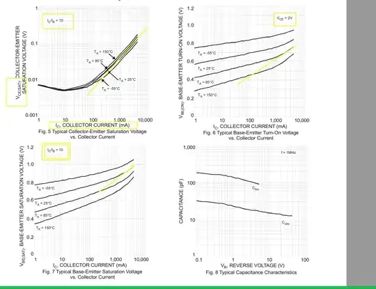

There is no formula for Vce(sat) because this bulk resistance is process dependent. The chip size, doping, layered etching methods all are factors.
You must refer to the Vce(sat) parametric model or datasheet for this property.
Diodes Inc (nee Zetex) has many of the earliest process patents of ultra-low Vce(sat) at high currents. They were also the first to characterize this as Rce, a linear resistance, in datasheets.
This collector-emitter saturation bulk resistance called \$R_{CE}\$ is defined for Vce=Vce(sat) at Ic/Ib=10 at various currents. In some cases, the log-log, or linear graph of Ic vs Vce shows the linear property above 10% of Imax.
example of Rce p.2 of 5 SOT-23
Prior to Zetex, you had to get a big power transistor in TO-3 can to get this low value of ~Vce(sat)/Ic.
Equivalent On-Resistance Rce(SAT) 35m typ 50 mΩ max. @Ie = 2A, Ib = 200mA enter image description here
