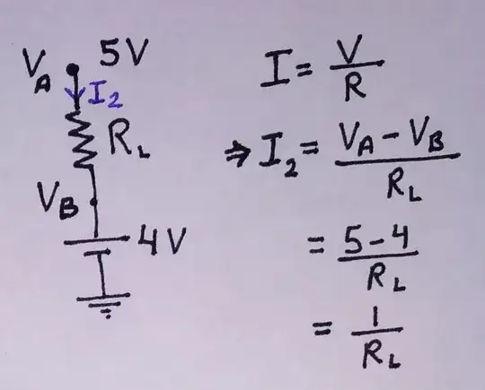

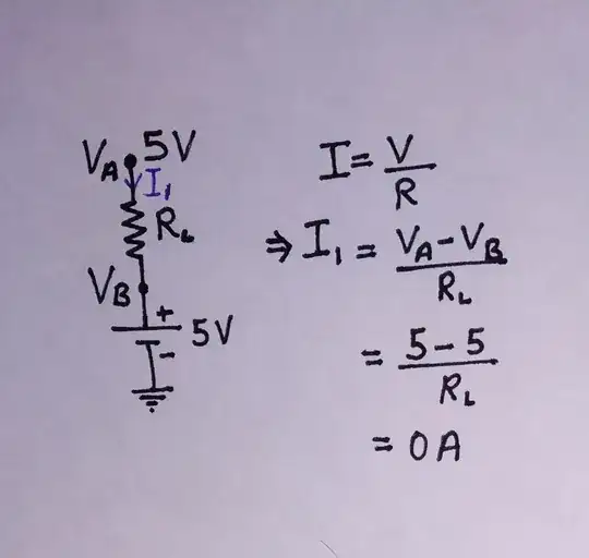

Let's look at the following circuit. In layman's terms, here a power source of 5V(connected at the top) is trying to establish a current in the circuit. But a battery connected with opposite polarity(with respect to the source voltage) is trying to oppose that current.
Now consider this next circuit. Here the battery connected is of reduced magnitude. Hence the current in the circuit increases.

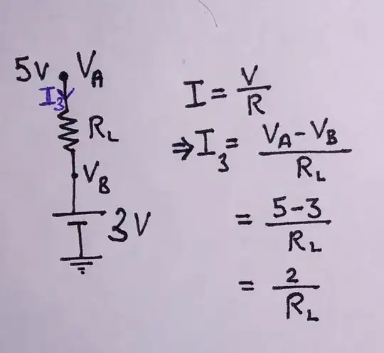

As you further reduce the battery voltage, the current in the circuit further increases.
The current goes on increasing and reaches the maximum value when the battery voltage becomes 0V.
