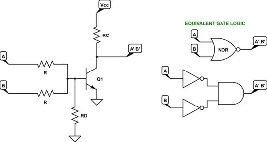

Before we go there, though, the above circuit presents a design problem. If we assume that both inputs (A and B) are at the highest allowable input voltage that is still considered a logical "0", then it's pretty clear that there will also be some small base current present and that this current will be amplified by the \$\beta\$ of \$Q_1\$ to become a possible collector current pulling down the collector voltage. This makes the circuit far less designable, especially because the value of \$\beta\$ varies over parts even within the same family. We need something present to make the circuit less dependent on the value of \$\beta\$. (We'll also need something to also make the circuit less dependent on the variations of saturation current [which affects \$V_{BE}\$], too. But that will shake out in the process.)
A way of achieving this is to add a resistor from base to ground (or some even lower voltage.) Something like this:
schematic
simulate this circuit
(I've shown this circuit with \$R_{D}\$ going to ground. A design could also consider the idea of tying it down to a negative rail. But there's no need, for now.)
The above circuit, with the added \$R_{D}\$ base resistor, greatly improves things as it allows us to divert small base currents away from the BJT. It provides an additional degree of design freedom that we'll find useful to have.

Here is the resulting circuit design:
schematic
Given the above, I figure \$V_{TH_{OFF}}\le 480\:\textrm{mV}\$ when both inputs are at \$V_{LO_{MAX}}\$ and that \$V_{TH_{ON}}\ge 720\:\textrm{mV}\$ when one input is at \$V_{HI_{MIN}}\$ and the other is at ground. This should provide enough margin for reasonable operation.
I think you will find that this works well with up to six loads on the output and works over the ranges I've discussed.

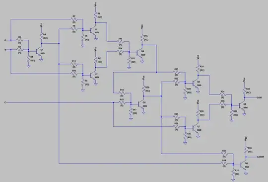

Fuller adder here:

  • @Nathan Great. I think you should have okay luck. I'll add a quick schematic of a full adder, just for fun. Look for it at the bottom. If this has helped, might as well select it as an answer. – jonk Jan 22 '17 at 06:28

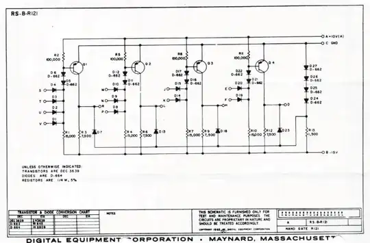

The PDP-8 minicomputer, released in 1965, used DTL (diode-transistor logic) contained on dozens of DEC R-series Flip Chip modules. For example, the R121 card was a set of NAND gates. A list of the R-series cards is shown on this page. Below is the schematic for the R121 card showing the DTL circuits:
Note it used both positive (10v) and negative (-15v) power rails, almost all of the power drawn from the negative supply. This particular card drew 0.4 mA at 10v, and 20 mA at -15v. 0v was considered a logic '1', and -3v a logic '0' and ran at speeds up to 2 MHz.
The schematics for the other cards (inverters, flip-flops etc.) can be found by Googling the R-series card number.
