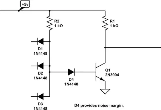

1,000 ohms from collector to +5, with 100 pf (approximately 5 loads) Cload on collector, achieves 100nanosecond delay in your NOR or Inverter.
Using 10Kohm into base, hitting the Miller Multiplication point, makes your logic very vulnerable to noise at that Miller pivot point.
Thus I'd use DTL NAND gates, with 1Kohm collector to +5v, and 1Kohm pullups on bases.
schematic
