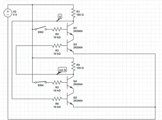

I'm trying to make a NAND SR-latch using only transistors, by combining a schematic for a NAND gate and a schematic for an SR-latch. The resulting circuit looks like this:
Combined schematic
(One thing not shown is that the switches are pulled down. Switches are normally closed, but I open them to Set or Reset)
Set and Reset work when I open them, but it is not stable when both are closed. It always goes back to Q, even though the circuit is completely symmetrical.
I've rebuilt the circuit to make sure I match the schematic, but still get the same problem. Is there something wrong with my resistor values, perhaps? (The NAND gate design works fine when tested in isolation.)

    One thing not shown is that the switches are pulled down - then show that in your schematic. Schematics come first, words come much further down the priority list. – Andy aka Feb 18 '22 at 10:49

Your circuit should have base bias resistors on the base of Q1 and of Q4. These are to bias the transistors off when the switches are open.
Otherwise, these transistors may/will conduct.
Instead of a resistor to ground, try adding:
  • 100K resistor across SW2/R2 junction and Q1 emitter
  • 100K resistor across SW4/R4 junction and Q4 emitter
The resistors should not be connected between the Q1/Q4 base and ground. That would put a negative voltage on the base.

  • Thanks! So just to be sure you're suggesting adding two resistors, right. The "100K resistor across SW2/R2 junction and Q1 emitter" is the "pull-down resistors on the base of Q1"? – Johannes Hoff Feb 18 '22 at 11:36
  • @JohannesHoff, it was badly phrased so I've clarified it. Might even affect the silent downvoter. Please reply back after testing that it solves your problem. – TonyM Feb 18 '22 at 15:32
    Thanks! I will try that when I get a chance. And I gave you an upvote to cancel the silent downvoter :) – Johannes Hoff Feb 18 '22 at 16:03
