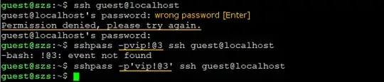

It looks the message Permission denied, please try again. is generated by the SSH client. The password should be quoted to escape the special meaning of characters as $, !, etc. (ref):
sshpass -p 'footbar' ...
Or you can use a file where the password to be stored (source):
sshpass -f "/path/to/passwordfile" ...
