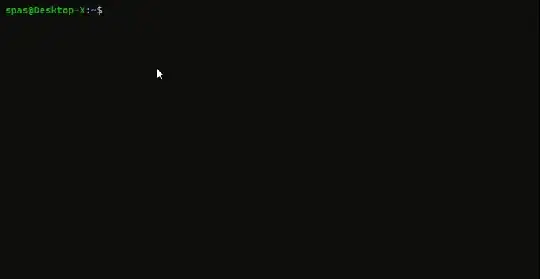

Here is one possible solution, within the references at the end of the answer are provided topics with more details. Here is how the script described below works.
1. Create executable script file, named populate-ssh-cmd. Place it into your user's ~/bin (or /usr/local/bin) directory to be accessible as shell command.
cat ~/bin/populate-ssh-cmd
#!/bin/bash
Get the user's input as command
[[ -z ${@} ]] && exit || CMD_EXEC="${@}"
Get the hosts from ~/.ssh/config whose names are prefixed by lan-
HOSTS=$(grep -Po 'Host\s\Klan-.*' "$HOME/.ssh/config")
Test weather the input command uses sudo
if [[ $CMD_EXEC =~ ^sudo ]] then # Ask for password read -sp '[sudo] password for remote_admin: ' password; echo
# Rewrite the command
CMD_EXEC=$(sed "s/^sudo/echo '$password' | sudo -S/" <<< "$CMD_EXEC")
fi
loop over the hosts and execute the SSH command, remove -a to override the logs
while IFS= read -r host do echo -e '\n\033[1;33m'"HOST: ${host}"'\033[0m' ssh -n "$host" "$CMD_EXEC 2>&1" | tee -a "/tmp/$(basename "${0}").${host}.log" done <<< "$HOSTS"
chmod +x ~/bin/populate-ssh-cmd
Note:
  • 2>&1 will redirect the remote STDERR to STDOUT, that is piped to the tee command, which will display it and also will write it to a separate log file for each remote host. To list the log files type ls -la /tmp/populate-ssh-cmd.sh.lan-*.
  • The script will ask for the remote admin's sudo passwords only once so the admins for all remote instances must have the same password.
2. Add entries for the LAN hosts in your ~/.ssh/config file and prefix their names by lan-. So the ~/.ssh/config file should look like as the follow.
Host lan-1-some-additional-info
    HostName 192.168.1.101
    IdentityFile ~/.ssh/lan-hosts/id_rsa
    User remoteUser
Host lan-2-some-additional-info HostName 192.168.1.102 IdentityFile ~/.ssh/lan-hosts/id_rsa User remoteUser
Host lan-3-some-additional-info HostName 192.168.1.103 IdentityFile ~/.ssh/lan-hosts/id_rsa User remoteUser
3. Use the populate-ssh-cmd script in a way as this.
populate-ssh-cmd sudo apt install -y firefox
The above script uses SSH key based authentication which is easier for such implementation and much secure than using password. If you want to use password based authentication you can implement sshpass -p 'footbar' as it is described within these references:
