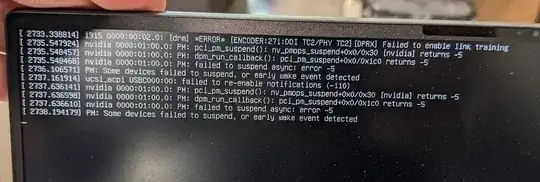

When resuming from suspend, I frequently receive a black screen which only contains this error:
i915 0000:00:02.0: [drm] *ERROR* failed to enable link training
This issue is a bit odd because most of the time touching the trackpad/mouse is enough for Ubuntu to resume successfully. Other times when I receive this error, my computer becomes unresponsive and requires a cold reboot.

    2. You press a key to wake it up. Nothing. You might see this set of errors quickly flash onto the screen, then it's just black:
      When you press some keys, you might see some backlight behind your keys if you had the keyboard backlight activated, but the screen remains black.
