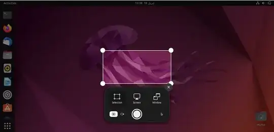

Ubuntu 22.04 comes with a out of box Screenshot App, when pressing PRINT. Taking a screenshot in 22.04
When a screenshot is taken, it will be automatically saved to ~/Pictures/Screenshots as PNG. Is it possible to alter that so the screenshots will be automatically saved as .jpg?

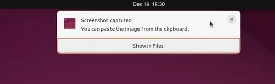

Press PrtSc, make your selection, and press Enter. It takes a screenshot and saves it by default at this path, for instance: /home/gabriel/Pictures/Screenshots/Screenshot from 2022-12-19 18-28-23.png. It also presents a pop-up at the top of your main monitor, like this:
Click on that pop-up (you have to be fast, as you only have a second or two), and it opens it up in your "Image Viewer" default image viewing app.

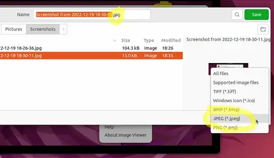

Change the extension in the "Name" box from .png to .jpg and click "Save" and Image Viewer will convert it to JPG for you.
You can also click the "Supported image files" drop-down menu at the bottom-right of the Image Viewer instead, to select your desired save format to convert the file to, as shown in this screenshot here:

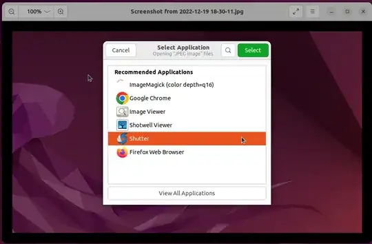

Once converted as explained above, the image is now a JGP file, and it is still opened up in the Image Viewer. Click the hamburger icon again but this time go to "Open With..." (you can see this option above "Save As..." in an earlier image above). Then, choose "Shutter". Either double-click it, or use the "Select" button:

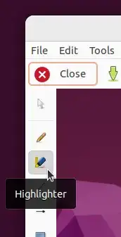

Choose the "Highlighter" tool:

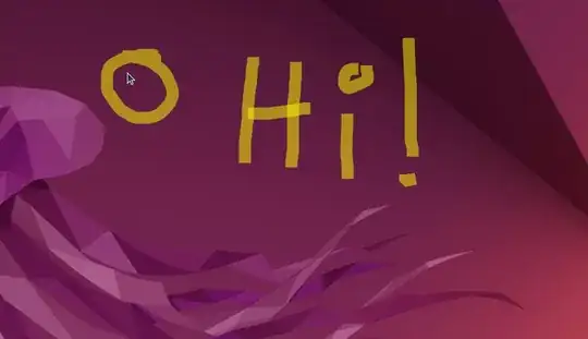

Then highlight and save:
