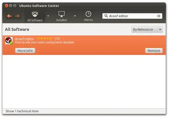

You first need to install dconf editor in Software Center. In my case it shows remove because I have already installed it

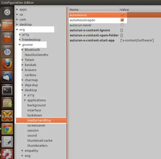

Then you need to open dconf editor via Dash
Then goto org.gnome.desktop.media-handling
You will find automount checkbox on right hand side. Uncheck it

Install dconf-tools, and run dconf-editor. Then see in dconf-editor, key
org.gnome.desktop.media-handling/automount

I believe you can find dconf-editor is part of dconf-tools. If you search for dconf, it should show up.
The key is under org. As posted, dig down to org.gnome.desktop.media-handling/automount.
