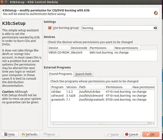

And then going to the k3b configuration screen:
k3b -->  Settings --> Setup System Permissions
and checking all of the following boxes:
  1. Use burning group: burning (this should work now)
  2. Devices: (Select the device you wish to use)
  3. External Programs: Found Programs (select the applications you wish to use)
Press 'Apply' and all should now be well :).

Finally here is a screenshot showing the final settings on my own system:
