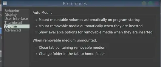

It's the third option to uncheck to achieve what you like. Check also the option of the "mount" widget in the panel. All of "volume" is also about USB.
standreas
  • 124
If you had gnome instead of lubuntu this would work. You have to make it in filemanager.
pcmanfm-qt --show-pref general
Sorry for german text in image.
filemanager
Where my mouse corser is it have to be untickt.
