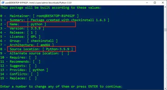

Make
Make is a program that’s used to compile and install programs from source code. It’s not a package manager so it doesn’t keep track of the files it installs. This makes it difficult to uninstall the files afterwards.
The make install command copies the built program and packages into the library directory and specified locations from the makefile. These locations can vary based on the examination that’s performed by the configure script.
CheckInstall
CheckInstall is a program that’s used to install or uninstall programs that are compiled from the source code. It monitors and copies the files that are installed using the make program. It also installs the files using the package manager which allows it to be uninstalled like any regular package.
The checkinstall command is calls the make install command. It monitors the files that are installed and creates a binary package from them. It also installs the binary package with the Linux package manager.
Replace source_location.deb and name in the screenshot with your own information:
Screenshot
Execute the following commands in the source package directory:
  1. Install CheckInstall
    sudo apt-get install checkinstall
  2. Run the Configure script
    ./configure
  3. Run the Make command
    make
  4. Run CheckInstall
    sudo checkinstall
  5. Reinstall the package
    sudo dpkg --install --force-overwrite source_location.deb
  6. Remove the package
    sudo apt remove name
