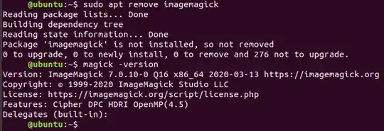

I installed ImageMagick via apt install imagemagick but then realised I need a newer version, so I compiled it from source and installed over the top of the old version. mogrify -version still showed the old version so I decided to remove everything and start again from scratch with apt remove imagemagick. However even after this I can still run imagemagick; i.e. it's not removed.
How can I remove it properly?
(And why did this happen in the first place? Why does apt remove not work?)
Related question: What is simplest process to get ImageMagick 7 with PNG support on Ubuntu?

The imagemagick package is a dummy package. From apt show imagemagick
 This package include links to channel depth specific binaries and manual
 pages.
 This is a dummy package.  You can safely purge or remove it.
The "channel depth specific binaries and manual pages" are provided by the package's dependency - you can check what that is using apt depends - for example:
$ apt depends imagemagick
imagemagick
  Depends: imagemagick-6.q16 (>= 8:6.9.2.10+dfsg-2~)
    imagemagick-6.q16:i386
(the q16 here refers to the the channel depth). If you installed imagemagick via apt (or apt-get) this will be the package that you need to remove.
If you installed the software by building it from source code, then please refer to
