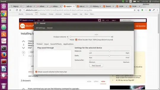

My sound setting does not have any output device even my headphone is attached.
