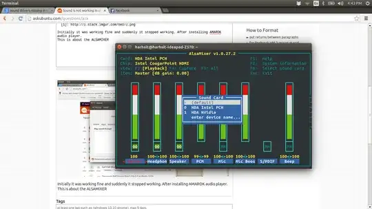

Initially it was working fine and suddenly it stopped working. After installing AMAROK audio player. This is about the ALSAMIXER
Looking for help ? Thanks in advance

  1. Reinstall alsa-utils
    sudo apt-get install alsa-utils --reinstall
  2. Download and install alsa-lib
    On this page you will find all versions https://launchpad.net/ubuntu/+source/alsa-lib
    Or find Here a link to version 1.0.25-4(the stable version)
    • Extract the archive and run the following code in the extracted directory
      ./configure && make
    • Then
      sudo make install
