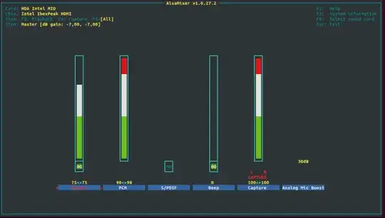

I have tried a number of models but none of them have worked. Additonally, many of the solutions suggest making sure the alsamixer are working. I notice that my interface for alsamixer seems to have less options than others, for example, there is no speaker, front or left, or headphone controller. Here is a screenshot of what I see in alsamixer: enter image description here
As you can see the card is HDA Intel MID and the chip is Intel IbexPeak HDMI.
