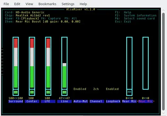

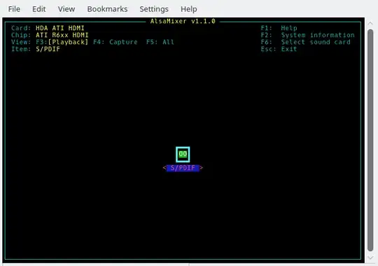

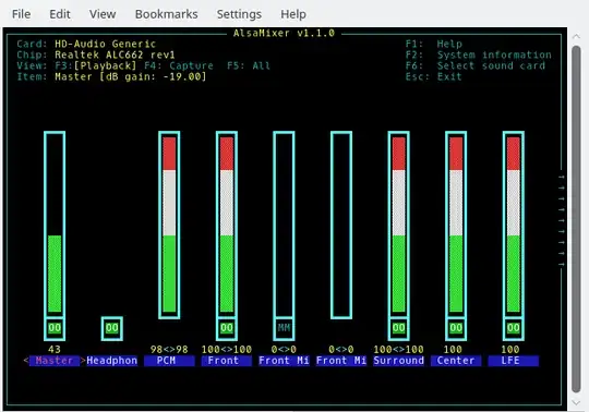

Could this image possibly help?:
There is another soundcard but I'm unsure of what its for because it never outputs sound, but it does have a lot of settings: that sound card is labelled as "HD-Audio Generic".

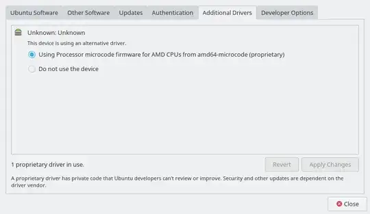

So I went into Software & Updates under the Additional drivers tab and I see this:
It was on Do not use the device so I changed it and applied the settings but unfortunately the soundcard isn't back even after reboot.
