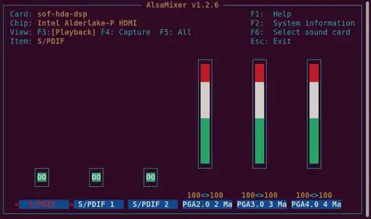

Linux n00b here, been using linux for many years but I'm a basic user. My next steps I believe is to try and install/configure pipewire. But I'm really not sure if it's a driver issue, or a configuration problem with pulseaudio and alsamixer.
Update 12/19/2023: Installing pipewire did not fix the issue. I've also consistently gotten a "System program problem detected" on boot, with no additional details. Unsure if issue is related.
Edit- Alsa Mixer screenshot: enter image description here
