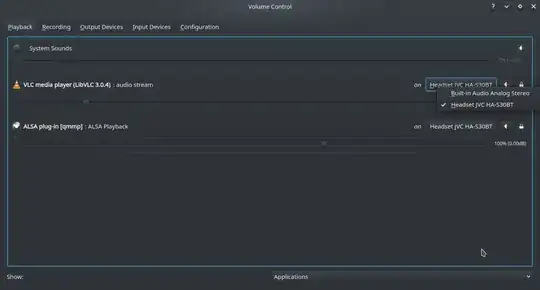

If you want two or more playback sources each in a separate output: that is possible with pavucontrol (PulseAudio Volume Control): you should be able to output each different playback source to a separate device, like for example VLC to headset and Qmmp to internal speakers.
Depending on your desktop the same options may be present in the default audio volume settings (e.g. in Plasma:Audio Volume Settings > Audio Volume > (tab)Applications).
