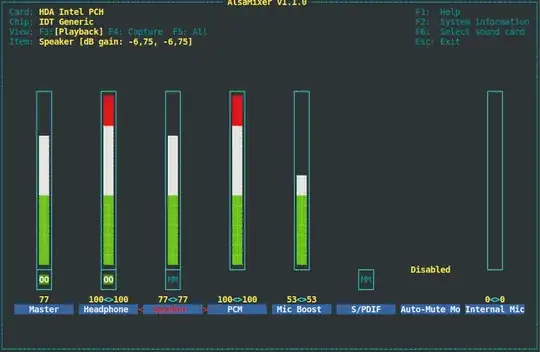

It may be a bit strange, but I need speakers work when headphones plugged.
I search the web and find only the issues when both of them work together. My system works fine. When I plug in my headphones speakers are off. But I need to enable them. Is it possible? It would be also cool to know how to roll things back to normal state.
I'm on Ubuntu 16.04 LTS.
--update--
Sorry, I forgot to say that I already inspected alsamixer and I see this. I tried to disable Auto-Mute Mode, but with no effect. I also changed the speaker volume, but have same result. enter image description here

Thank you for your time everybody, playing farther I eventually noticed MM sign below the volume bar. It means muted. It's changed via m button. Speaker volume and auto mute must be also properly setup.
