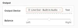

When line-out is selected as the output device, the sound is heard only from the speakers connected to the line-out port. No problem there.

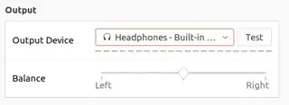

However, when headphone is selected as the output device, the sound is heard both from headphones and the speakers connected to the line out port.
This is really strange and beats the very purpose of the headphone, namely, privacy and not disturbing others.

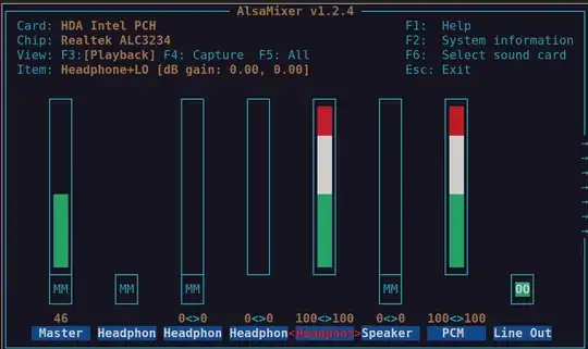

I am not sure whether the output from alsamixer will be useful. But here it goes anyway.
