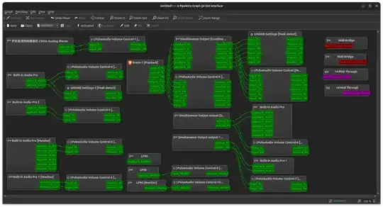

Update:
I just discovered qpwgraph. Below gives a visual of the. I notice a few repeated modules, I wonder how it got there.
qpwgraph
Any advice on what to do would be great.

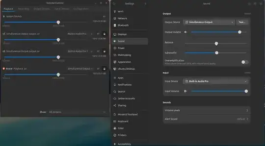

I noticed that whenever I change the output device on Settings -> Sound or in pavcontrol (i.e. Volume Control) -> Playback -> Brave: Payback on, the connections can get messed up badly. This is the source of the problem.
pavcontrol

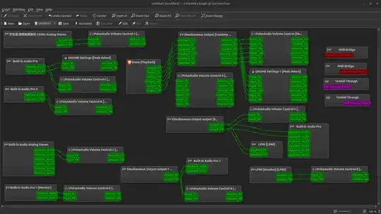

To solve the mess, qpwgraph can be used to fix and customise the sound connections of the various devices. I just have to select the connections I want to connect and right click the mouse and select connect. Sound setting has become so much simpler with pipewire enabled in Ubuntu 24.04.
customise 1

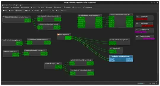

The next picture shows how I am even able to direct sound from youtube on Brave Browser to both the Built-in Audio and bluetooth speaker without even needing to use the new “Simultaneous Output” output device.
customise 2
