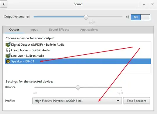

    Now you should be able to set your device to A2DP and enjoy high quality music:
    Sound settings

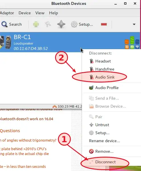

    Notice that sometime you need to Disconnect and Reconnect your device to re-enable A2DP:
    Bluetooth devices
