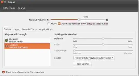

Sound Settings
This is the picture of it paired however there is no audio coming out of it whatsoever. I read someplace else that this is a known issue. I'll update this post once I find that link.
