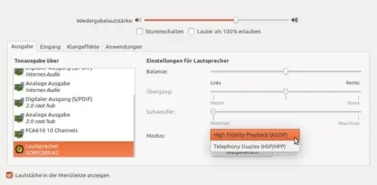

Go to Sound Settings, select your Bluetooth audio device and check that the device is set to A2DP not HSP/HFP (which is mono and has very low quality).
Edit: If Bluetooth audio stops working after you do that in 16.04 you need to apply the following workaround: https://askubuntu.com/a/817926/40581
